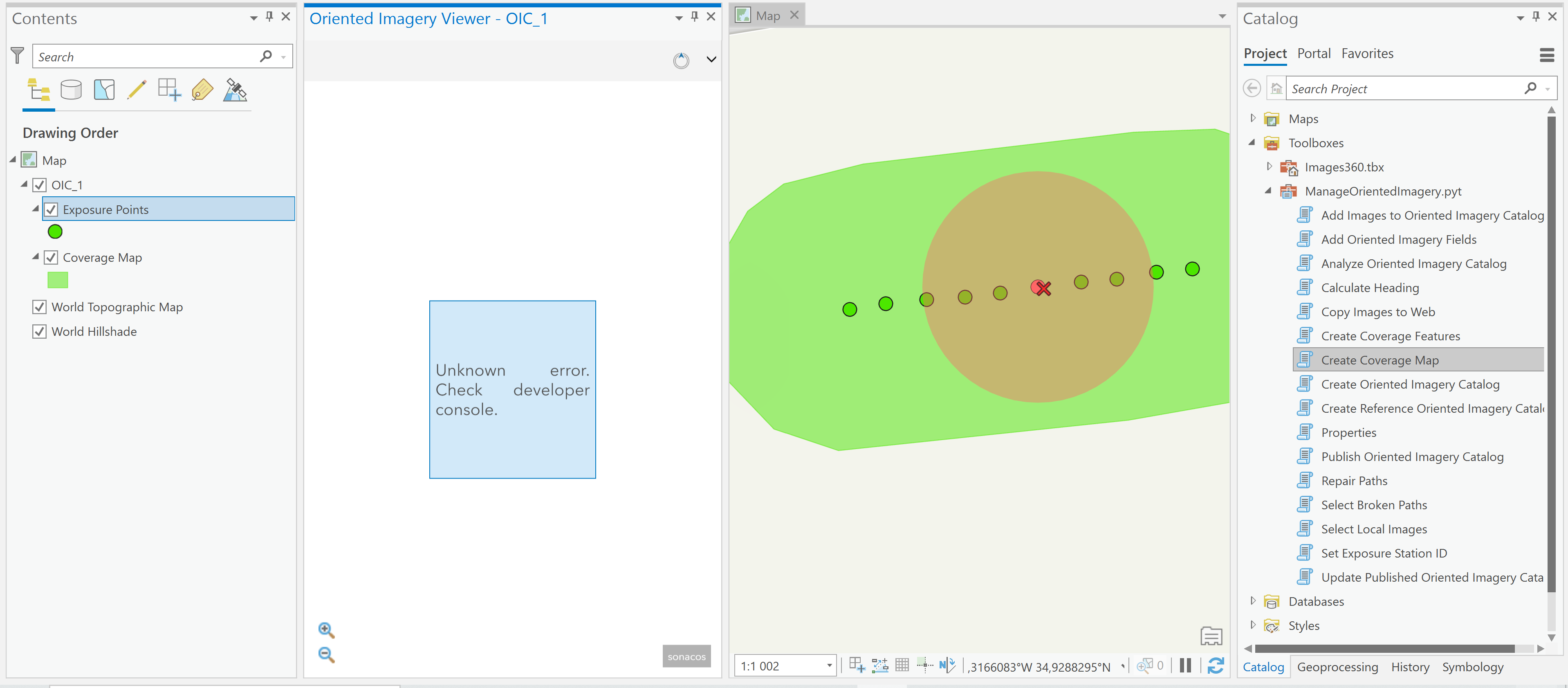

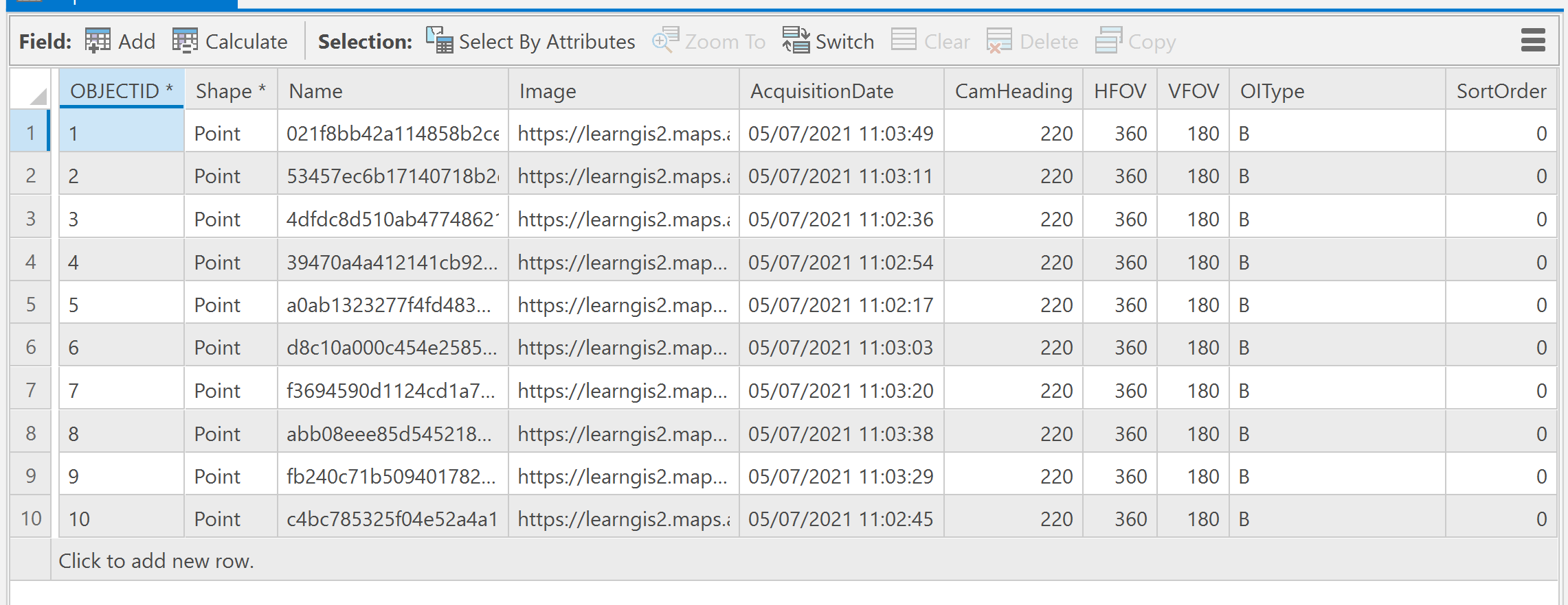

Hi, I've been trying to view my Terrestrial 360 Camera images. First, I've created an oriented imagery and I've added only 2 images and it worked even through it worked on some specific points and not the whole covered area. Now that I've added 8 more images nothing is showing in the viewer. And It keeps showing "Unkown Error .  Check developer console". Please keep in mind I've added these images to my contents in ArcGIS Online and saved them as public and that how I've used them even in the first try and it worked. I'm going to link the images and the screen shots of my ArcGIS Pro and the attribute table.

 Hi Fatima,
I created a OIC from your data using the same versions mentioned above and it worked for me.
Is your OIC published online? If not can you publish it and see if you are facing the same issue.
Also I would suggest after publishing it use a new ArcGIS Pro session to load and view the OIC. if necessary close your existing ArcGIS Pro project.
You can also try loading your OIC using the sample Web app that we have. You can find it here.
If you get the same error please share the OIC with me and I will trouble shoot from my end.

RandallRebello
Hi Fatima,
What version of Pro are you using?  And also can you check the version of the Addin you are using.
Randall

FatimaZahra_Mokhtari
Hi Randall,
I am using ArcGIS Pro 2.8.2. And for the Oriented Imagery Add-In it's 2.7.1.
Hi Randall,
My OIC was not published online I thought that I should fix the problem before publishing it. But after I've published it and I reopened it It worked. Thank you for your help.
