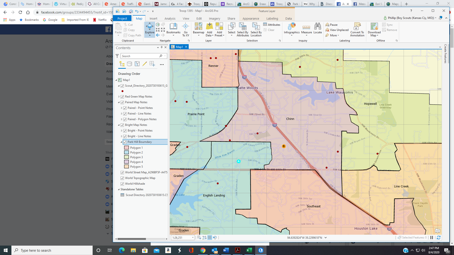

I added some address to a map and there were a couple the geocode feature found multiple.  Two of the alternative addresses are showing as points on my map and I can't remove them - even after I removed the table of addresses I had added to begin with.
The A with the bright Blue circle and the B in the Yellow circle are unwanted.

Lukas, I tried to respond directly to you.  Here is the screen capture. the A & B are the points I can't delete.  I used the edit > select > delete function, but I can't get points to move.  Even if I turn off all the other layers, they are still there.
The red points are where Boy Scouts live.  We are working with the district to look at how we should recruit new scouts.

Have you tried deleting the features within the attribute table?  If that doesn't work, a simple workaround would be to select all the features except for those two points, then exporting those selected features to a new layer.  Let me know how that goes for you!
