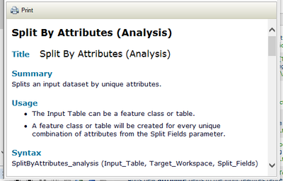

JayantaPoddar
MVP Alum
Also attaching the integrated GP tool Split by Attributes - ArcMap, which I guess, got inspired from Dan_Patterson‌'s work.
