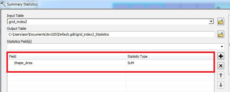

Hi Jay - I've now got the FGDB and have imported the shapefiles...do I run Summary Statistics? This gives me an invalid pointer error message.
Thanks, Steve
Sent from my iPhone
JayantaPoddar
MVP Alum
Make sure to define statistics field and statistics type as sum in Summary Statistics.
