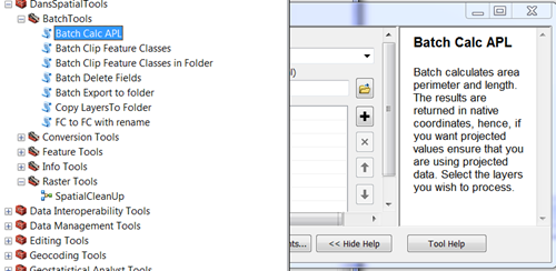

Oh they exist...ArcScripts 2.0 is coming soon...
StephenWheeler
Deactivated User
Hi Dan — Thanks, but where do i find Batch Calc APL? I don’t see it anywhere.
