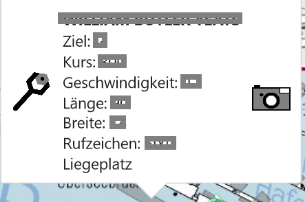

On UWP it is working allright, having proper layout and behaving as expected. (UWP screenshot below)
UWP callout

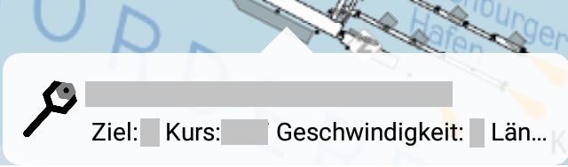

On Android however the System.Environment.NewLine(s) are ignored completely.
Exact the same callout is rendered lenghtly (just two lines height) and the button is not visible.
Android callout
I have tried different approaches to no avail.
The only way to have the button visible, is to reduce the text to 3 (three) letters!
(Removing the icon seams to have no influence)
Android callout only three letters - button is visible
Is there any way to influence the layout of the callout? Thus be able to put some more text (as on the UWP) and left the button visible on the callout

sorry to say, but no, I was not able to solve the problem. What I did is to show just one Button with Icon on the Callout. The Button shows dedicated information Xamarin.Forms form that is designed and rendered as needed / expected.
