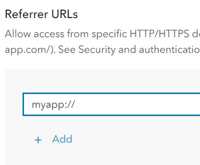

You can also specify an actual referrer url like this:
And then in the app configure it to use that referrer:
