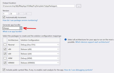

If you want an installer that'll install on both x86 and x64, you can use the app bundles in the MSIX publishing:

Yes .NET 6 does native libraries a little different, since it now has first class support for native runtime libraries.
Were you also using an MSIX installer in your .NET Framework app?
CameronCross
Yes, we were using MSIX in our .net framework app as well.  Thanks for the info on the app bundles.  It seems like that's what we're looking for.  I appreciate the help.
