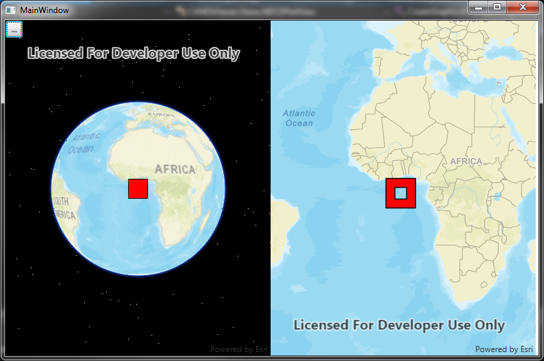

Referencing the attached picture
polygon with hole issue
Both Views (SceneView on the left, MapView on the right) have a single, multi-part polygon added to a single graphics overlay. The problem is that the MapView correctly shows the hole in the polygon, but the sceneview doesn't.
Full project attached.
Any sugguestions?

I ran into a maybe-related issue when building polygons.  I found that if there is a donut the inner ring must always be counter-clockwise.  You can use the Simplify command to fix them, at least I think it can always fix them.  I found the note at the bottom of the polygon builder docs:
Note: Interior rings to make donut polygons should be counter-clockwise in direction to be topology correct. If there is ever a doubt about the topological correctness of a polygon, call the Simplify(Geometry) method to correct any issues. This is especially true if you pass a polygon to ArcGIS Server for a geoprocessing task to avoid any ArcGIS Server errors being thrown.
PolygonBuilder Class
Here is the reference for Simplify as well: GeometryEngine.Simplify Method
Hope that helps!
Christopher
DavidHope
BTW, I've discovered that if I reverse the order of the points in the interior polygon, it then works on the SceneView also...

Christopher,
That was very helpful. Even more so, because while looking at Geometry Engine, I discovered that I could use the GeometryEngine.Difference method to do exactly what I wanted to do (and it makes sure that polygons are all spinning the correct direction).
