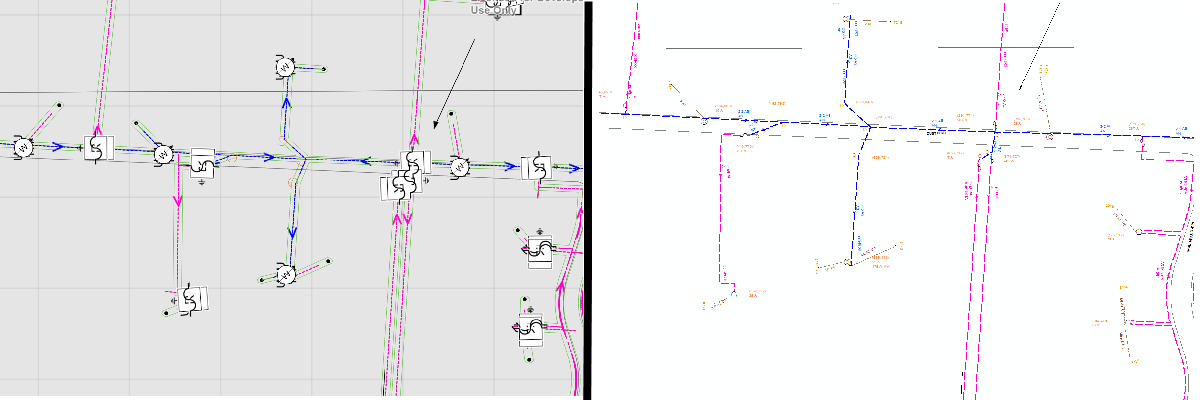

I've recently created some runtime content from ArcGIS 10.2.2 and noticed that the symbology rendered on the ArcGIS Runtime Map is not the same as the symbology rendered on ArcGIS 10.2.2 map. Several symbols have been changed in the runtime content and I can't figure out what happened.
Here's an example - the left picture is from the Runtime map (SDK for .Net v10.2.4) and the right picture is from the ArcGIS map (v10.2.2).

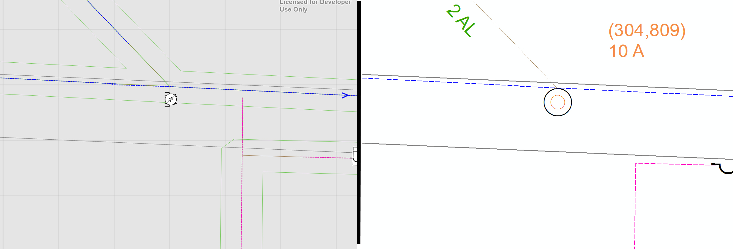

Closer view on one location - also noticed that pink dashed line (lower right quad of the map) is not the same in the runtime content, the 90 degree turn to the south was extended north. I've seem several instances where line routing was been altered in the runtime content.

Did you set the definition query on the feature layer when constructing them and assigning the table to each of them?
FeatureLayer.DefinitionExpression Property
Note: you're exporting the table data, not the layers - so you would have to configure the layer the same way as what you had in ArcMap.
