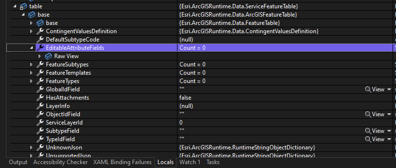

Hello! I need an offline syncable geodatabase. I am trying to read fields from a geodatabase, but the results are empty.  None of the fields load.

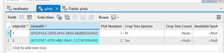

The table has fields, I'd expect to see these headers:

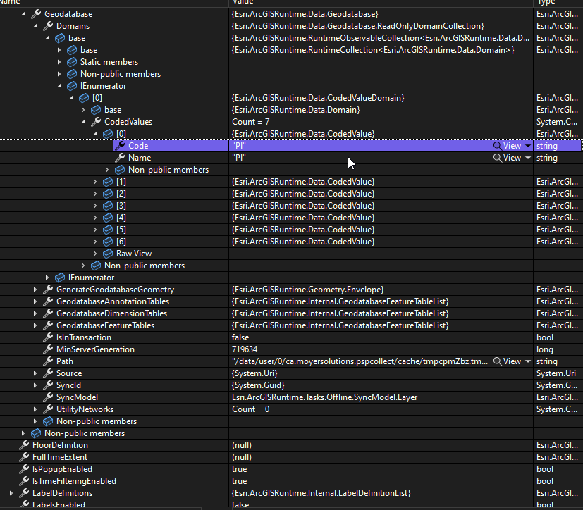

Strangely enough it seems to loaded the Domains , so I know its downloaded the correct table:

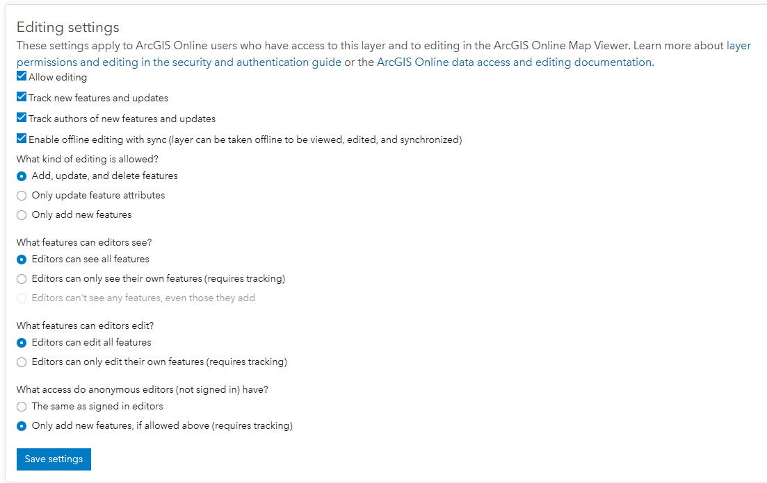

Editing is enabled in the service, and all users should be able to view features:

So I have tried to make a smaller test case using ServiceFeatureTable or through ServiceGeodatabase:. Results are same: empty table
public static async Task ServiceGeodatabase() {
    var serviceGeodatabase = new ServiceGeodatabase(new Uri(featureServiceUri));
    await serviceGeodatabase.LoadAsync();
    ServiceFeatureTable table = serviceGeodatabase.GetTable(0);
    _ = table.Fields; //breakpoint here, why this is empty?
-or-
public static async Task GetServiceTable() {
    ServiceFeatureTable table = new(new Uri(featureServiceUri));
    var layer = new FeatureLayer(table);
