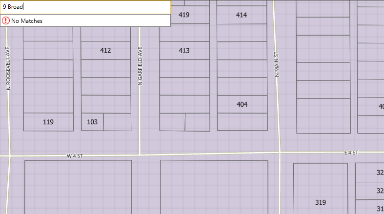

I'm seeing a difference in the way the suggestion/geolocation functionality works in ArcGIS Pro compared to Runtime.  I've finally come up with a locator that works the way I want it to in pro, but it does not work the same way in runtime.
Search in Pro:
Pro Locator Search
Search in Runtime:
Runtime Locator Search
If I put 9 E Broad in the locator search in runtime, it turns up a result, but that's exactly what I'm trying to avoid.  As far as I understand, I'm using the same exact locator in both Pro and Runtime.  Please tell me I'm missing something obvious here!

PreetiMaske
Hello again Kyle,
I have some update on the issue with differences in suggest results returned.  When performing Suggest operation, Pro automatically uses an extent to limit results. So doing a runtime search with just the text is not the same. So, to do a search that is similar/same you need to set SearchArea on SuggestParameters to the same search area Pro uses. But getting the two to use the exactly the same values is not easy. I tried following extent that gave me first two matching results that I see in Pro. You might have to refine search extent to get results matching Pro.

PreetiMaske
Hello Kyle,
I spent some time with your repro case and found two issues:
1. In LocationSearchBox_KeyUp, you would need to call SuggestAsync() instead of GeocodeAsync() since at that point you ar etrying to get the suggetsions.
2. I also found the binding of results doesn't work with Telerik Autocomplete control. If I replace the control with the list box, I see the results as expected.
Can you try these changes and let me know if it works for you?
--Preeti
KyleGruber
Preeti,
I must admit I'm a bit shell shocked right now.  I replaced the Telerik RadAutoCompleteBox with a simple TextBox/ListBox combination and the behavior seems to work perfectly as exacted now, putting in 100 Main now for instance pulls up all of the 100 N/E/S/W Main(s) as desired.  I have no idea why the RadAutoCompleteBox was causing different behavior, I can only guess that SearchText is behaving differently than Text does on a normal text input element.
Also, on the KeyUp routine, I was using that basically as a last resort.  It's checking for the Enter key, not a text change, and if there are no suggestions it's trying to geocode what is typed in the box as a last resort.
Thank you very much!
