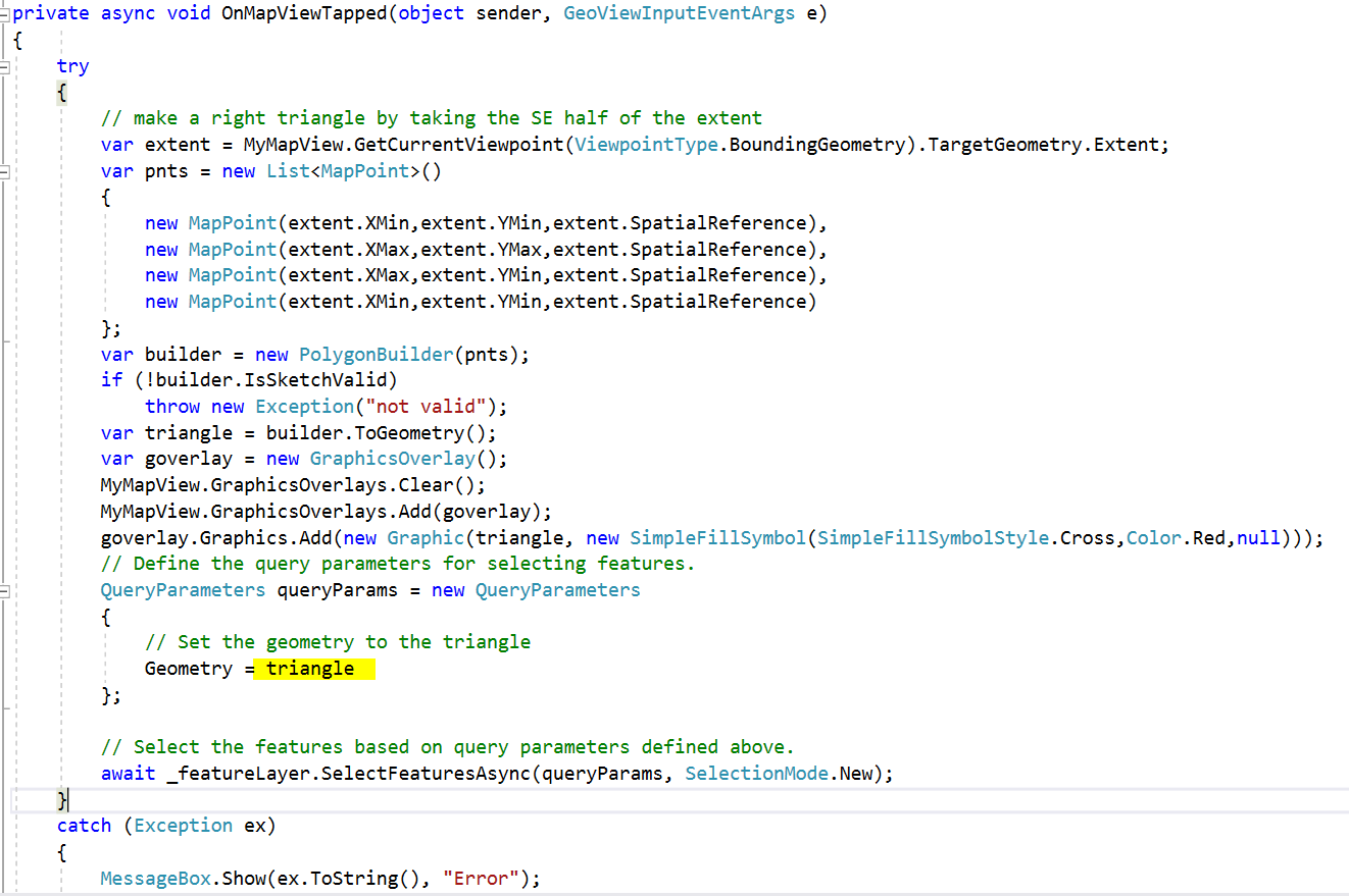

Maybe this is a bug.  If not, How can I select with a triangle?
I modified the Feature layer Selection sample to call SelectFeaturesAsync with a triangle created from half the current mapextent.

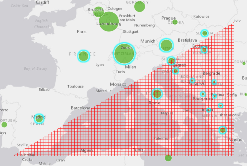

It appears to be using the Extent of the triangle instead of the actual triangle. I would not expect it to select anything outside of the hatched triangle.

I was able to reproduce this issue from GeoViewTapped Event Listener with specific points. The funny thing is if you run the same exact code where its not in an Event Listener/Button it will select the features just fine within the triangle.
Outside button/event listener:
Inside button/event listener:
I have also seen some sporadic behavior on this where if you click while zoomed in partly over this triangle it will again select correctly. You likely won't see that sporadic behavior when using the MapView's extent to create the triangle.
I will get started on logging a bug for this issue. If you let me know your customer number I can create a case and attach your organization to it so it will be trackable in My Esri.

That's some strange behavior.  I'm able to consistently reproduce it by using the polygon I get from SketchEditor.  I am calling sketcheditor StartAsync from a command tied to a button though.

BUG-000122510: In the ArcGIS Runtime SDK, selecting features on a feature layer using featureLayer.SelectFeaturesAsync() uses the geometry of the polygon extent rather than the geometry of the polygon itself when querying from an event listener.
