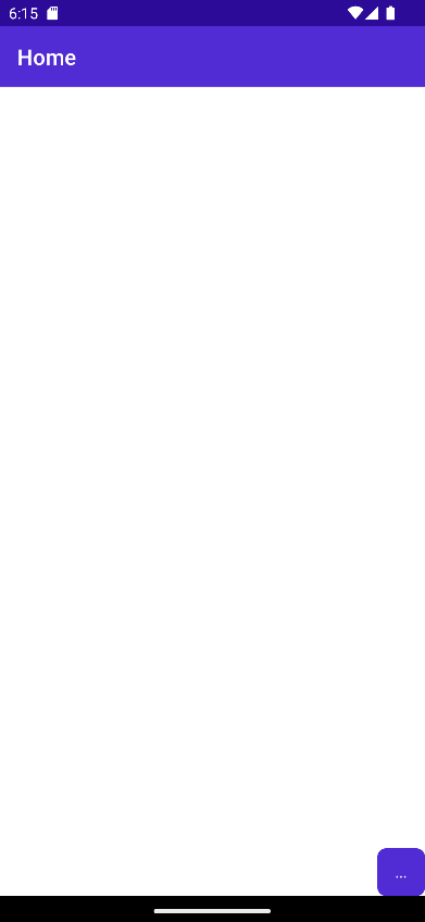

If I put the MapView into a Grid with Auto-Columns/Rows the page stays empty:

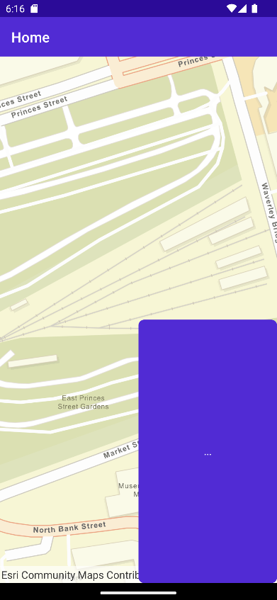

If I use just Star-Columns/Rows everything works fine:

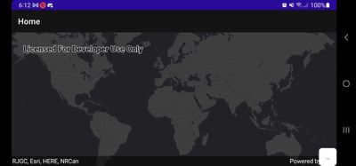

Sorry for the slow follow-up. I've been spending some time debugging this, and I'm 99.9% sure this is a layout bug in .NET MAUI, and not in the ArcGIS Maps SDK. It's sending some weird layout parameters when you use the specific configuration you have above, causing the map to size itself to 0.
However I did find numerous other ways to get the layout you want without triggering this bug, so you should be able to move forward.
MatveiStefarov
I think you're right, Morten.  The bug disappears when building the reproducer with latest Visual Studio Preview.  There have been many layout bugs fixed in MAUI recently, perhaps this has already been taken care of by Microsoft.
