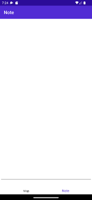

Then use the lower tab buttons to switch to the "Note" page:

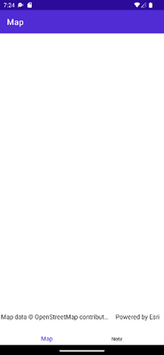

Switching back to the "Map" page shows the watermark, but now map:

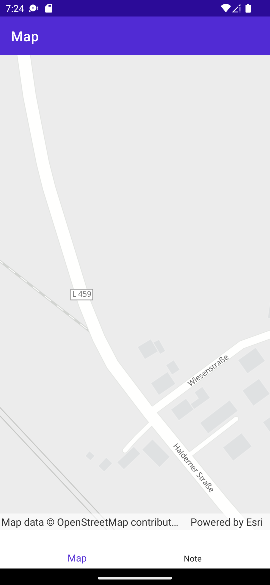

If you just move the finger on the "empty" map, it appears again.
