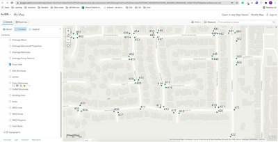

YashvitNaik
ArcGIS Online Map ViewerArcGIS Online Map Viewer
The labels are also visible on ArcGIS Online Map Viewer. So JavaScript applications don't have client-side code to show labels.
MichaelBranscomb
Esri Frequent Contributor
The ArcGIS Online Map Viewer is a web app built with the ArcGIS API for JavaScript, therefore the behavior may different from the out-of-the-box ArcGIS API for JavaScript map control.
Regarding displaying labels in your ArcGIS Runtime app, because the service definition does not contain a label definition you will need need to add in code. For a sample see: https://developers.arcgis.com/net/wpf/sample-code/show-labels-on-layers/
