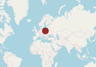

I have a weird problem in my Xamarin ArcGIS Runtime app. The label is not present next to my feature:
It took me a while, but I managed to find the missing label by rotation the MapView...

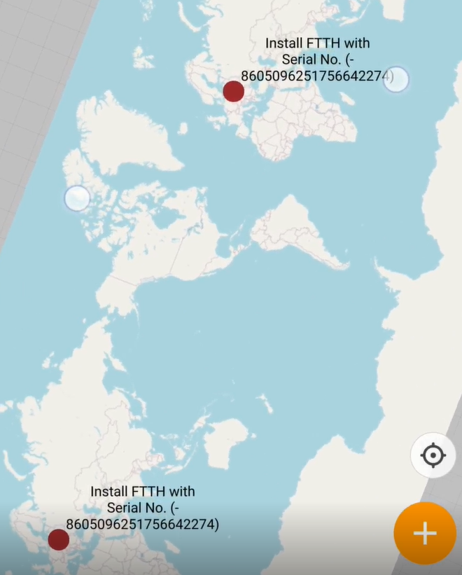

When I pan the map to the left, both duplicates of the label are shown, but when I try to zoom to any one of them, only the other one stays visible.

The problem disappears when the labels are short, a 3 letter label poses no problem. The more letters the label have, the easier it disappears from the view.
