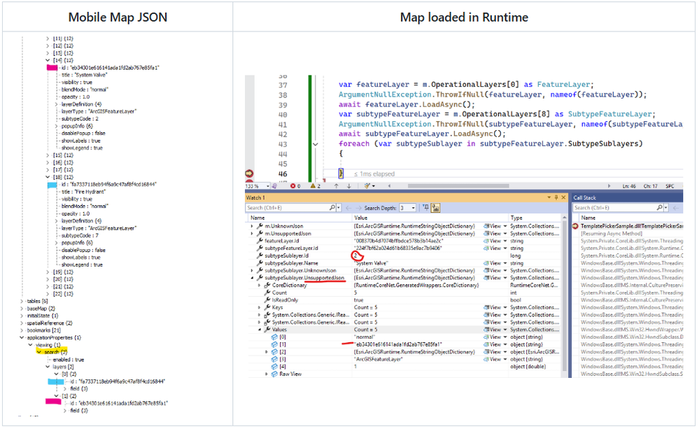

The "id" on this search is a string so it will not match the sublayer. There is however, a SubtypeSublayer.unsupportedJSON property that is deprecated and will be removed in the next release that contains the "id" string. JSON on the left can be web/mobile map, watch window on the right is from map loaded in Native SDK for .NET.
