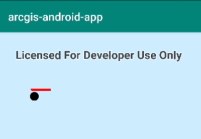

This seems to be working fine with 100.15.0 for ArcGIS Runtime SDK For Android.
I am able to visualize the MultilayerPointSymbol that includes SimpleMarkerSymbol (converted to multilayersymbol first)
I built up on the code you shared above.
Below is the full code sample:

I see that in your code, the width of the SolidStrokeSymbolLayer is 1 and the size of SimpleMarkerSymbol is 5. I had to increase the width and size respectively, as I couldn't see them initially on my map.
Another issue could be that we need to set the correct viewpoint to view the symbols.

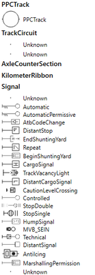

thanks for responding. The width and size used to work fine in 100.11, so I doubt that would be the issue for me. Also I'm using UniqueValueRenderer to visualize the symbols. The weird thing is that the symbols are visualized in the Legend:
The problem only occurs when visualizing the symbol in the map.
