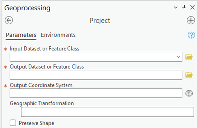

  • Open a tool or properties dialogue that displays coordinate system, like Project

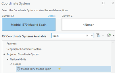

  • Click on the globe icon to get to coordinate system options
  • Select Projected Coordinate System, and enter 'Spain' in the search.
  • Expand on the Projected Coordinate System to view the suggestionsAyanPalit_0-1691665205913.png

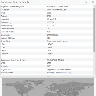

  • Right-click on the coordinate system and click Details to get more info.
