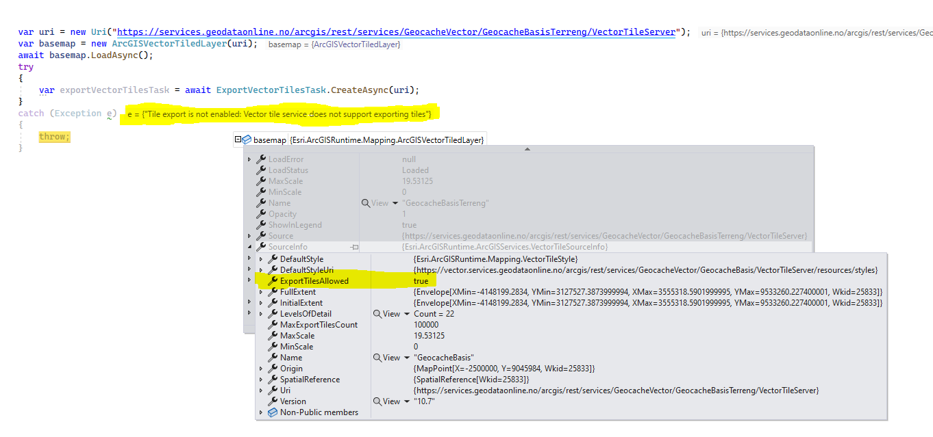

The following code fails with an exception even though the service states exportTilesAllowed=true.
Exception: "Tile export is not enabled: Vector tile service does not support exporting tiles"
I've included code for loading the basemap using ArcGISVectorTiledLayer which accurately parses the exportTilesAllowed as true. See the screenshot.
var uri = new Uri("https://services.geodataonline.no/arcgis/rest/services/GeocacheVector/GeocacheBasisTerreng/VectorTileServer");
var basemap = new ArcGISVectorTiledLayer(uri);
await basemap.LoadAsync();
try
    var exportVectorTilesTask = await ExportVectorTilesTask.CreateAsync(uri);
catch (Exception e)
    // fails with: "Tile export is not enabled: Vector tile service does not support exporting tiles"
    throw;
I've also tested with "https://basemaps.arcgis.com/arcgis/rest/services/World_Basemap_Export_v2/VectorTileServer" which works just fine.
Using ArcGIS Runtime for .NET v100.13 @WinUI 3

You can see the curves and hillshade layers that exist in addition to that specified in the GeocacheBasis layer.
One of those, GeocacheHoydekurver has this JSON definition which has exportTilesAllowed set to false, which is disabling the overall layer:
You would need to reach out to the service owner to see if they could enable exporting tiles for the GeocacheHoydekurver service.

esp1rl
That explains alot. Thank you for your quick response.
