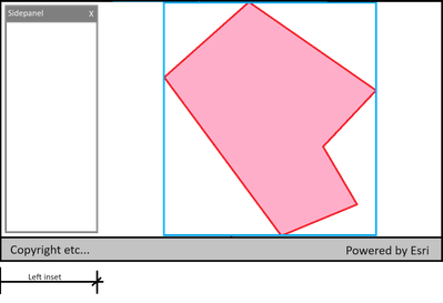

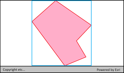

If you zoom to the red polygon below (or its blue extent), the map will zoom to it in such a way that it guarantees the feature will not be blocked by the attribution bar. Example:
Are you seeing this not working and the extent you go to is obscured by the attribution?
These are called view insets, and it automatically will add the attribution to the inset. You can further add to the insets but setting the GeoView.ViewInsets property to add additional padding. For instance if you have a 200px wide side panel you sometimes have open, when it's open you can add that to the view to ensure when you pan or zoom to a viewpoint, it won't be obscured by the feature:
myMapView.ViewInsets = new Thickness((isPanelOpen ? 200 : 0), 0,0,0);

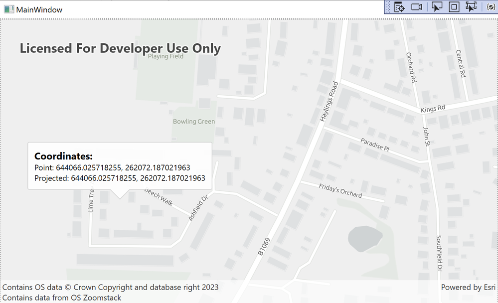

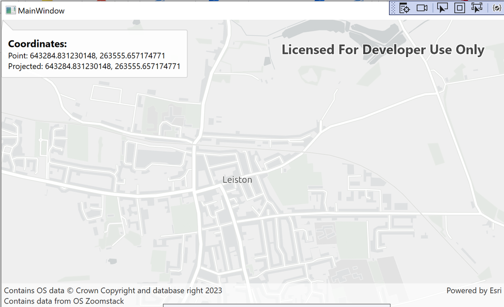

In our case, it isn't. Our goal is to get the exact screenshot given a viewpoint. In our example we set the viewpoint to
[XMin=643337.447936 YMin=262073.813165 XMax=645931.670118 YMax=263557.442529 Wkid=27700] on MapView dimension set to [761, 435]
ArcGIS runtime returns this screenshot with viewpoint at
[XMin=643275.904459005, YMin=262073.813165, XMax=645993.213594995, YMax=263557.442529, Wkid=27700]
For reference, here's what it looks like in-app:SS1.png
The Y component is equal to what we supplied meaning we should expect the Y to be as exact to what we're after.

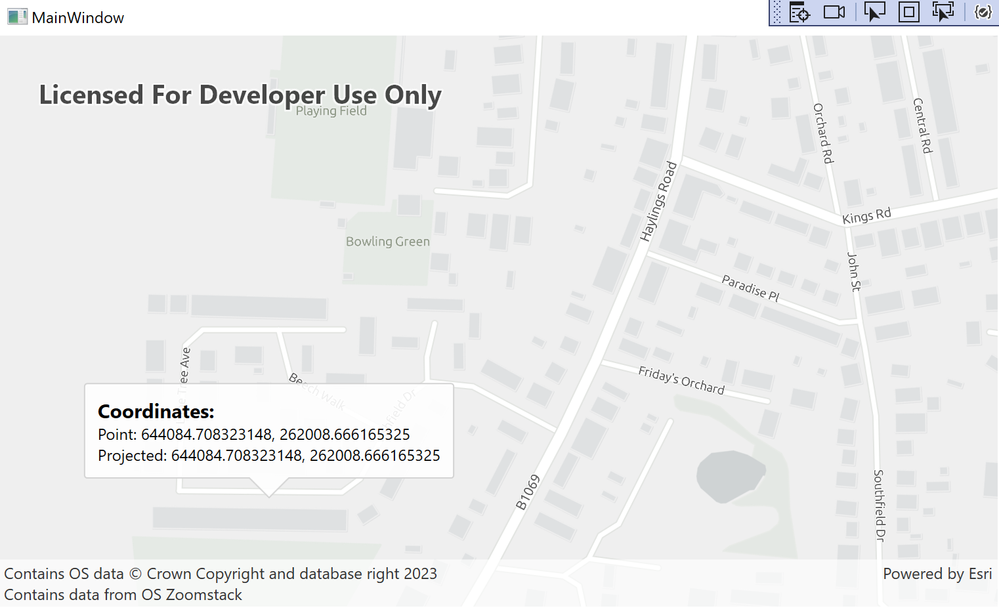

However, upon inspection, the bottom pixel is at 266008 which is off by 64 world units.
Here's where we expect the bottom border of our screenshot should be:
I tried hard-coding half of the height of the attribution text (measured from paint) and cropping that amount relative to the screenshot and it perfectly brought out the exact screenshot. This perfectly works in my machine but It will probably mess up in another machine unless I can get exactly how tall the attribution text is.
