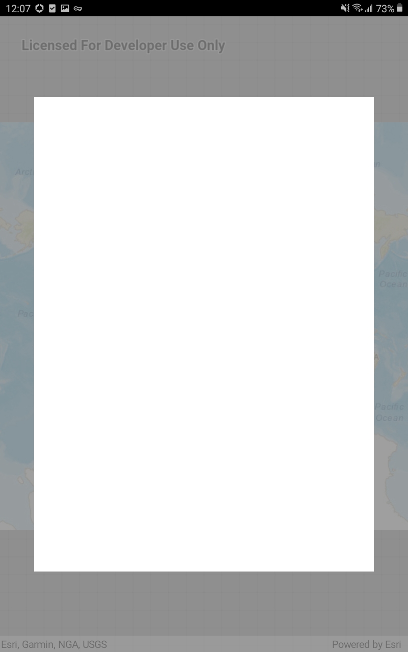

Anybody here with the experience of getting Enterprise ADFS login working with Xamarin Custom Android app using .net SDK?
  • Facing issue with authenticating to enterprise GIS portal.
  • Using .Net SDK 100.7 & Xamarin Forms 4.5 ,
  • Exactly following the demo here :
    • https://developers.arcgis.com/net/latest/forms/sample-code/authenticate-with-oauth/
When we click on Enterpirse login, the screen blanks account. In ESRI's Collector app, we get the popup for entering Username and password. We would like to get the similar behaviour for the user to enter the ADFS login credentials.

Thanks Tamilmani, Rajesh‌. Could you provide more info on the issues you're experiencing. For example, are you seeing any errors returned from the Runtime (and what are they)?
by Anonymous User
Not applicable
We can reach till Enterprise login option
@ Nicholas Furness When we click on Enterpirse login, the screen blanks out. In ESRI's Collector app, we get the popup for entering Username and password. We would like to get the similar behaviour for the user to enter the ADFS login credentials.

Nicholas Furness‌ We have tested against the Runtime WPF security login sample and that is does indeed work.

Thanks. That confirms it's most likely the Android HTTP Stack that has some problems with authenticating against that specific service. Unfortunately Xamarin.Android doesn't have a great single http implementation that fits all scenarios.
I'd recommend trying picking a different HTTP stack for Android as documented here: HttpClient Stack and SSL/TLS Implementation Selector for Android - Xamarin | Microsoft Docs

Morten NielsenNicholas Furness‌ We have tested the app using external internet connection against ArcGIS Online. The app works successfully.  It can authenticate against feds(our ADFS) when access from an external network but not when on internal/VPN. Meaning that, the app works outside our office network. Does it point to anything?
