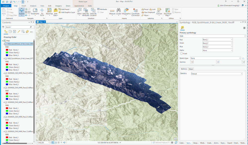

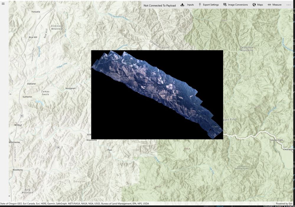

When i load this geotiff into my ArcgisRuntime UWP app i have black borders where there are no valid pixels.  When i load the same geotiff into arcgisPro, i get transparent borders.
Is there a way to show these "non-valid pixels" as transparent in my arcgis runtime UWP app?
geotiff under question is attached.
 no borders in arcgisProno borders in arcgisProblack borders in arcgisRuntime UWPblack borders in arcgisRuntime UWP
