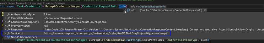

Basemap prompt request without Token from SDK.
Esri.ArcGISRuntime v200.0
Esri.ArcGISRuntime.WPF v200.0
Esri.ArcGISRuntime.Toolkit.WPF v200.0
