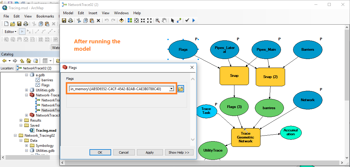

After running a model, the source of a feature set entry data is indicated as the following:
in_memory\{AB5D6552-C4CF-4542-B2AB-CAE3B0788C40}
what does this mean?
Thanks,
Alaa
NeilAyres
MVP Alum
That's just the temporary feature "in_memory" for the feature set.

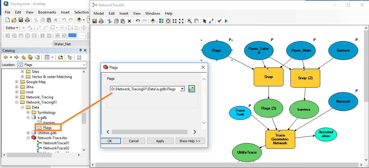

You are using the flags.lyr to set the schema (data type - polygon, line or point) and symbology.
AlaaFlaifel
Thanks Neil,
Will the model stay effective if I used it for another data or in another machine?
Best
NeilAyres
MVP Alum
Yes it should do.
I always tick the box "make paths relative" on these sort of tools.
