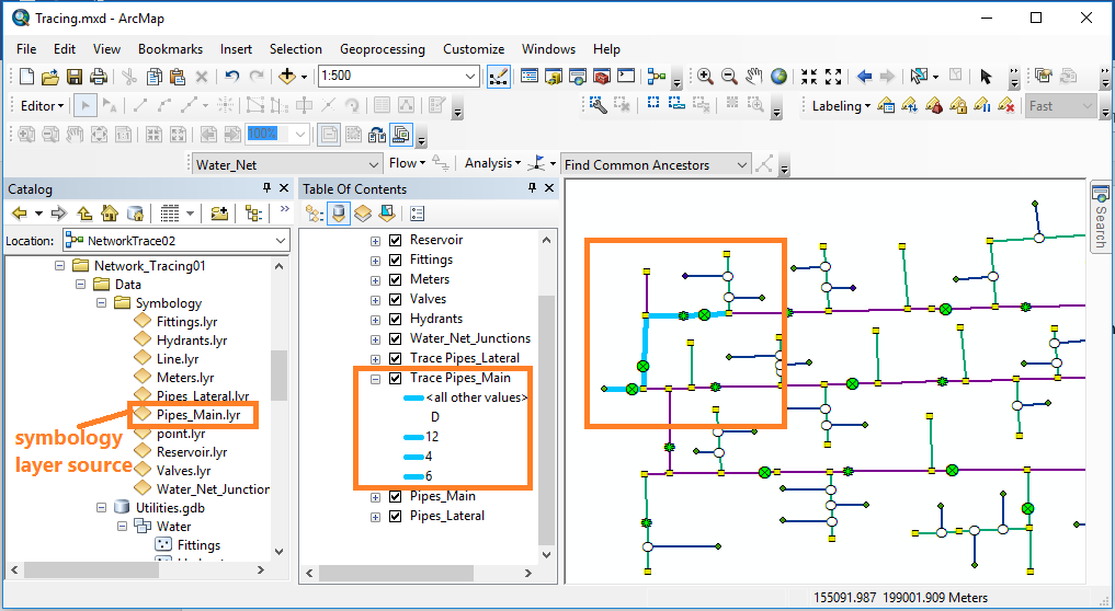

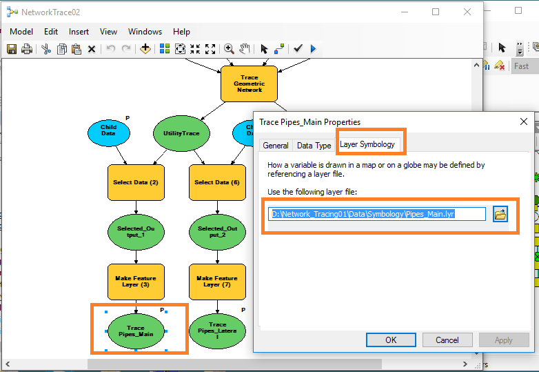

You can add a Layer File parameter to the model to let the user select the symbology file (*.lyr) and then in the model run the Apply Symbology From Layer for the output.
