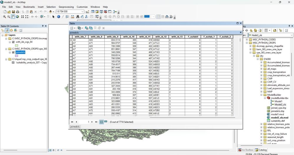

hi there. so i have this shapefile with polygons for my country. there is a column called sub_cat with values 1 - 5838. I also have a xls. file with information regarding these sub_cat. both files have the column sub_cat with same amount values. when i try joining these together normally it works perfect and when I export the data I can see every column with original names. however i have tried doing this in model builder and when I open the exported shapefile after the join i see all the added columns but they have names corresponding to the file name. see attached photo showing this. i have tried adding the a csv file and dbf file neither work. I have this in arcmap and now in Pro. is there any way to fix this problem.Screenshot (74).jpgScreenshot (75).jpgScreenshot (76).jpg

Are you seeing
Maintain fully qualified field names (Environment setting)—ArcGIS Pro | Documentation
which is referenced in
Add Join (Data Management)—ArcGIS Pro | Documentation
Check your environment settings in the model or consider
Join Field (Data Management)—ArcGIS Pro | Documentation
as an alternative to "add join"

SimonLake
i think i figured it out. I used the join field tool instead but specified the transfer method to 'use field mapping'. this seems to have worked perfectly.
