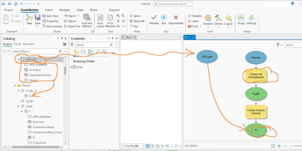

JamalNUMAN
Legendary Contributor
I followed the steps but couldn’t figure out how to copy the features classes from the file geodatabase to feature dataset as per the screenshot below

JamalNUMAN
How to import the feature class from file geodatabse into feature dataset in a new file geodatabase?
