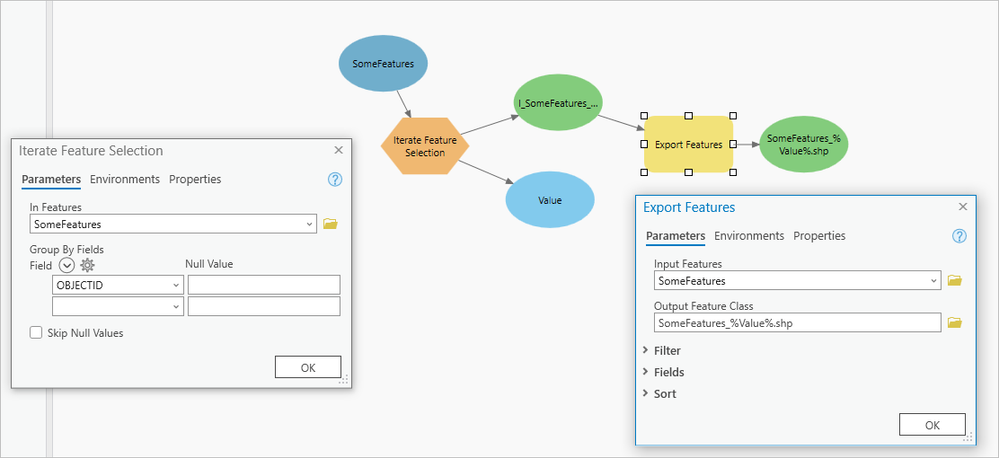

You can definitely automate the export part.
In Model Builder, add your feature layer, add the Iterate Feature Selection (https://pro.arcgis.com/en/pro-app/latest/tool-reference/modelbuilder-toolbox/iterate-feature-selecti...) Iterator tool. Choose to group by Object ID (or whatever unique value). Connect the output features to Export Features tool. Export to a folder, specify a base shapefile name, insert "_%Value%" just before the shapefile .shp extension (this is called inline variable substitution).
Run the tool.

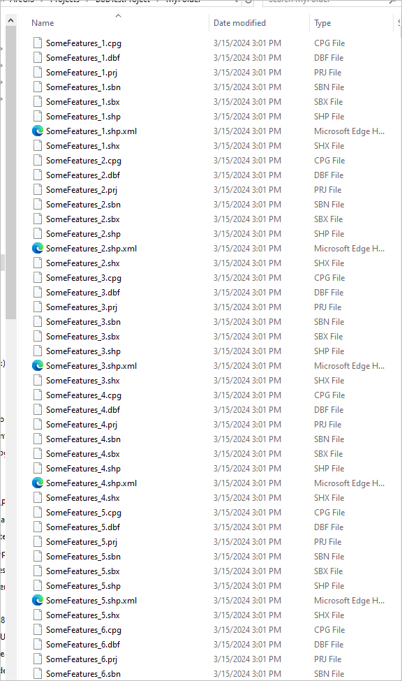

 You'll get something like this in your output folder.
I don't see a Zip GP tool, but you could create a quick PY script and set it up as a script tool, then add that to the model.
