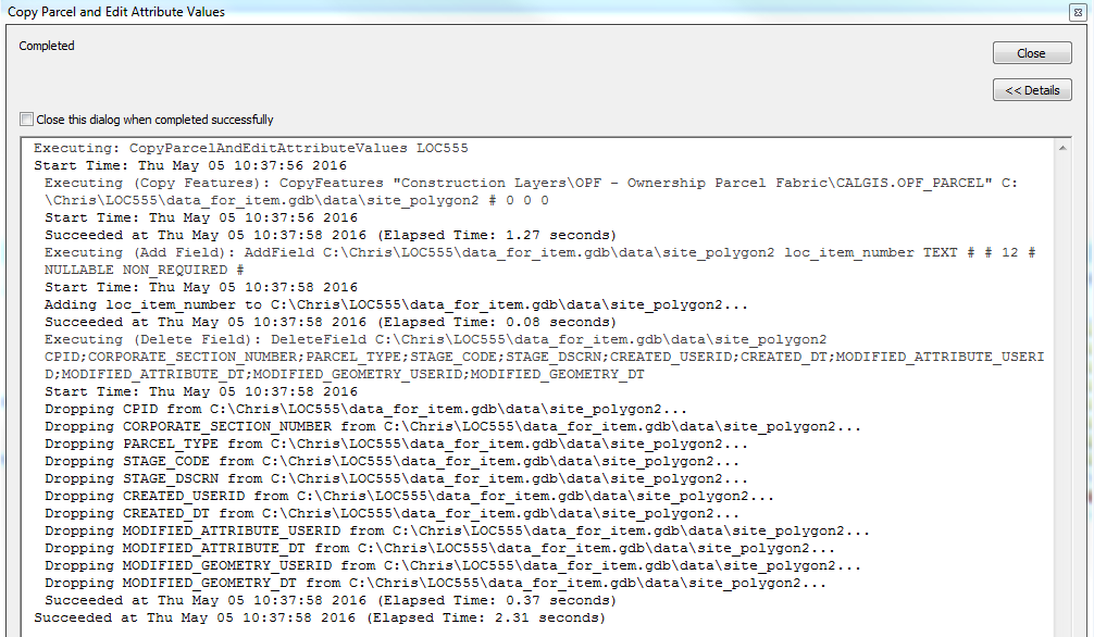

Which seems to run fine (based on the output to the dialog display):
But even though the output shows that the "Copy Features" tool created "site_polygon2", I cannot find it in Catalog (even after refresh):

I'm not sure, but in the Copy Features part of the message it appears that the source data path includes two folders that contains spaces in their foldername, plus one has a dash in the foldername, and there may even be a period thrown in the next one.  Both spaces and dashes (and periods) in the path can cause geoprocessing to not work as expected.  Consider renaming the folders "Construction Layers" to "Construction_Layers" (or something similar that does not have a space between the words) and likewise remedy the folder off it to so it does not have spaces and the dash (and remove the period if it is there).

Here's the message part in question (please see highlighted image).

The output path to site_polygon2 looks fine:
