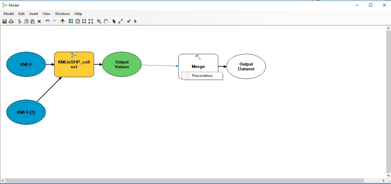

I'm trying to automate a very large batch conversion of kml files. I ultimately want a single shapefile or feature class with all of the kml files info and geometry. I've got the conversion part working but getting them into a single output file is where I'm stuck. My model:
It won't let me link to the merger tool using the outputs from the iterator as the input.

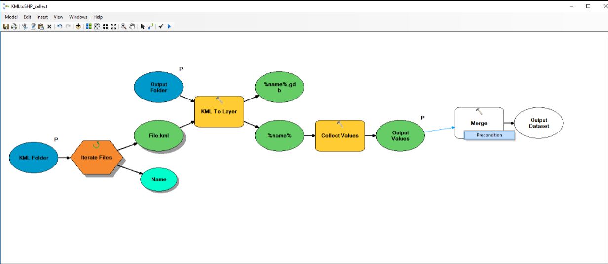

I've also tried nesting the model above in a new model to then perform the merge:

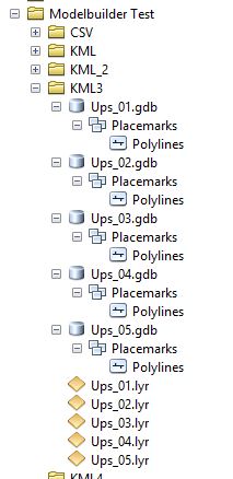

Same result. Something about the kml to layer output isn't jibing. Here's a view of the output workspace of the conversion:Workspace.JPG
The names of the feature class in each GDB has been giving me problems and I guess could be the issue here.

1- You should check shapes types (Point - polyline - polygon), you can't merge different types in single output.
2- replace Merge tool with Append Tool.
