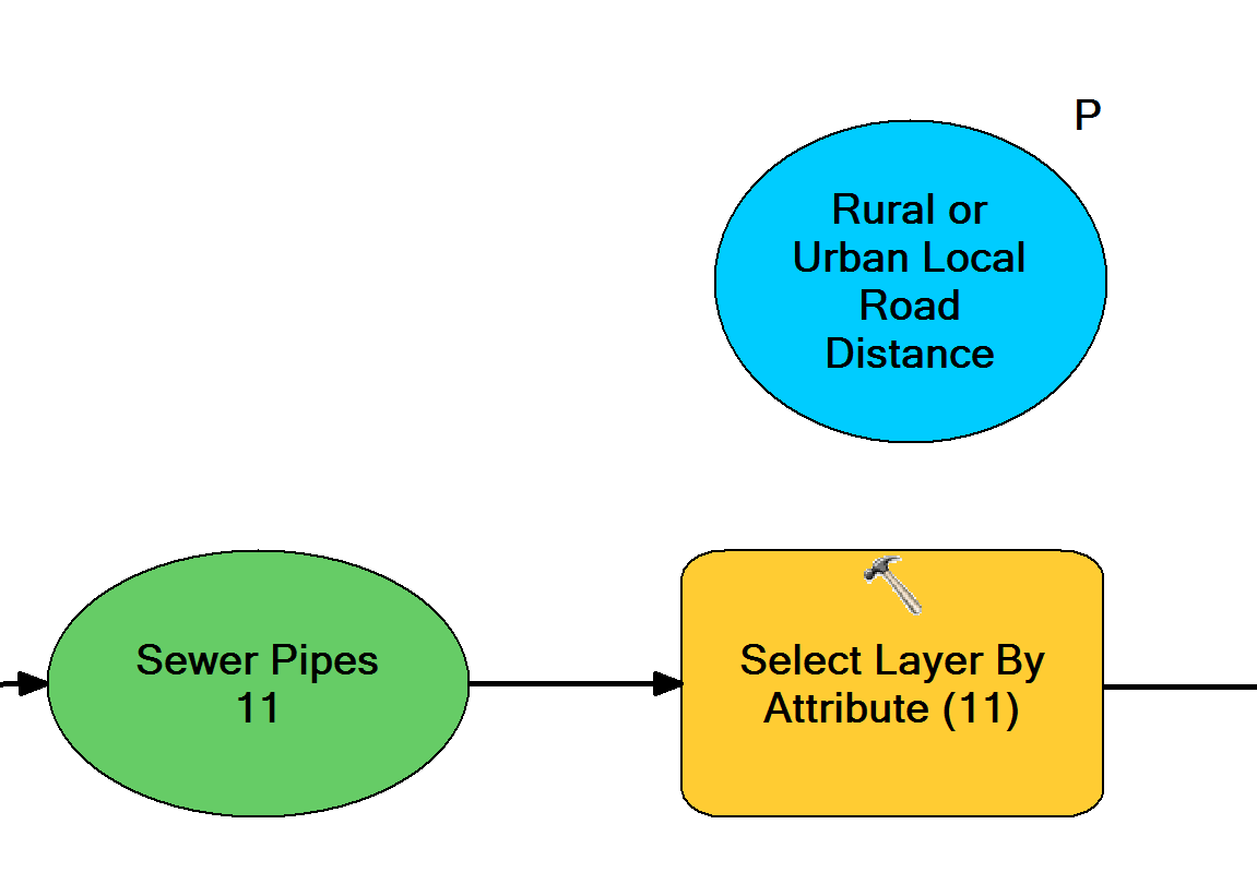

Is it possible to change the default value of a parameter if the user selects a different value before running the model?  For example, if the user wants to change the distance in a distance parameter (from 20 feet to 50 feet), then the next time the user runs the model 50 feet will be the default value.  Assume this user does not know how to alter the parameter defaults values in model builder itself. They just want to run the model.   Any help will be appreciated.
What I need to happen is after a user changes the parameter value in the model, when the model is run again, the new value is now the default value.
Parameter set up in Model

a model parameter has a P beside the input, meaning that it needs to be input  no P, means a local parameter
see the diagram and anything you want to change needs a P

Thanks Dan.  I have all of my parameters set up in my model.  Maybe my question wasn't clear.  I've updated the original question to show what I meant.
DanPatterson_Retired
MVP Emeritus
one of your parameters isn't connected to the model workflow.  Perhaps you need to do so, or reorder the parameters in the model.  Even though they may appear in logical order, the actual order depends on how things were added or edited during the workflow
