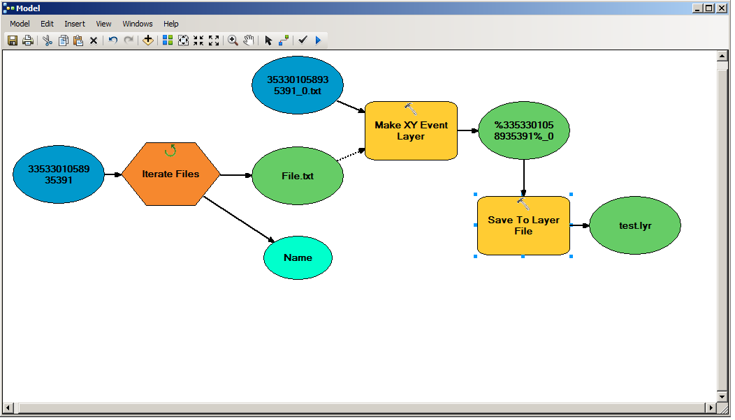

Hello everybody,
I have a folder with multiple text files containing X Y data. I would like to transform each of these txt files into a .lyr file.
I thought I could work with Model Builder but I think I have problem using "Files iterator".
For each txt file, I would like to obtain one .lyr file but by running the below model I obtain a single file (and not several one).
Could you please help me ?
Pieter_Geertvan_den_Beukel
The Iterate Files tool has an output format (file) that can not be connected to the Make XY Event Layer tool. Use the Iterate Tables tool instead.
See NewModel in attached toolbox.

RaymondHuang1
Looking at your model, your make xy event tool will only run once. Your make xy event tool should take in the output of the iterator as an input(solid arrow) instead of a precondition (dotted arrow) like what it is now. Can you try to change this and let me know if it works for you?

I don't know why but when I try to connect the green box "File.txt" and the tool "make xy event layer" it is always a dashed line (precondition) and not a solid one.
perhaps I have to fix something with the name of the Input / output...I don't know what's going wrong

Great, Thank you !
I thought I had to use the "File iterator"...I don't know why I never tried this "Table iterator"...
