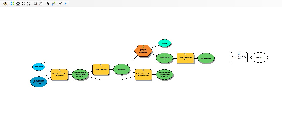

I'm using ArcGIS 10.3 and I am making a model
I need to add a tool
continue after iterrate feature selection
but when I add the tool and run the model
It makes every iteration from "select Layey By attributes"
ChrisDonohue__GISP
MVP Alum
One way to get around this may be to break your model into 2 models, then join them using a third model.  This will prevent the Iterator from unnecessarily running all the parts before the iterator again and again.
Model 1 - does the part before the Iterator.
Model 2  -is the iteration and what comes after.
Model 3 - joins the two.  Build the first two models, then drag them from your toolbox into your Model 3 edit.  Add a Precondition to Model 2 to trigger when Model 1 is done with the final process.
