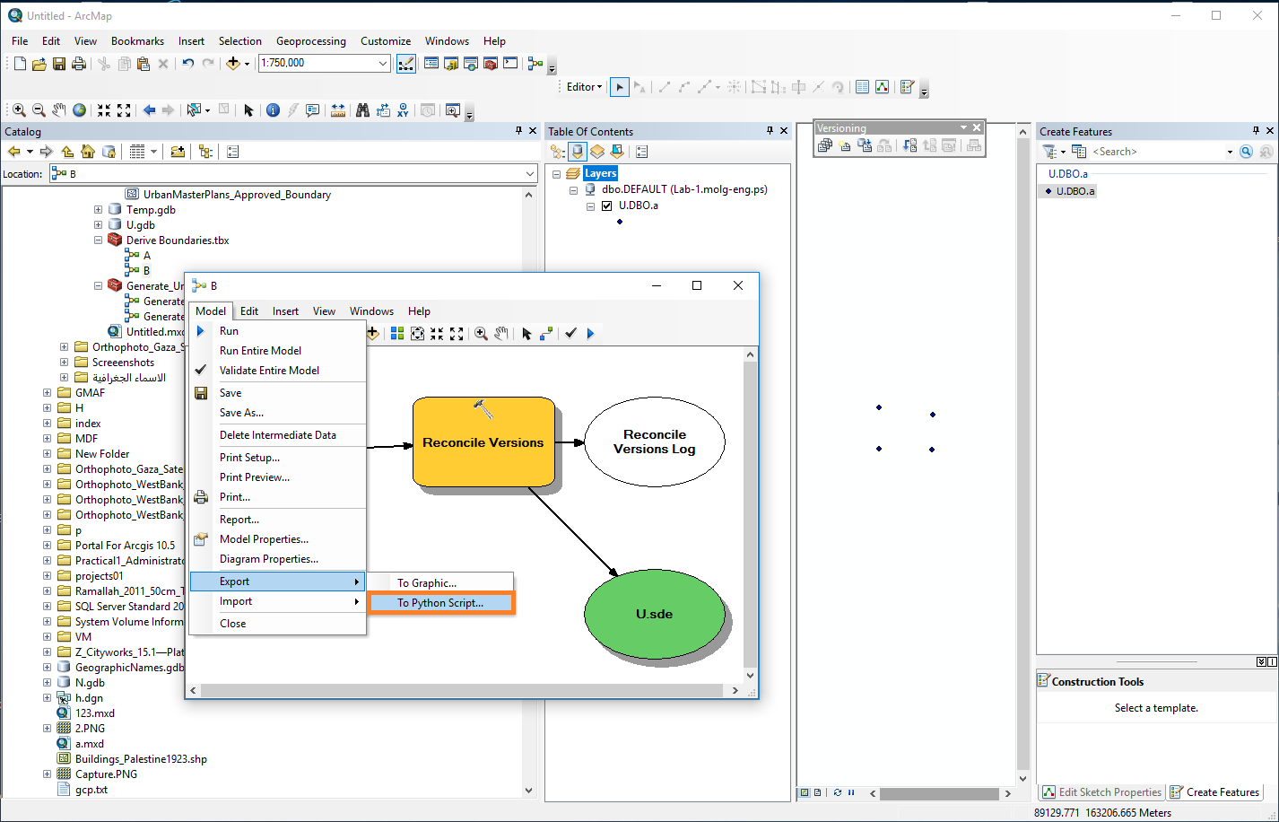

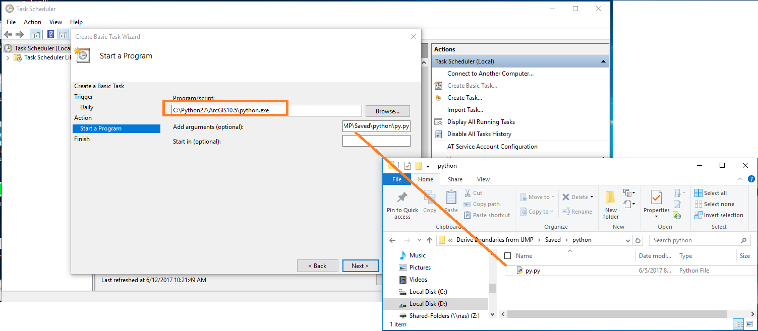

I’m trying to run a model automatically every one hour based on Windows Schedule. I tried to run the exported python of the model using Task Scheduler but the exported python didn’t run successfully although the model is running as expected in Arcmap.
What do you think about that and Is there a method to schedule a model other than using its exported Python.

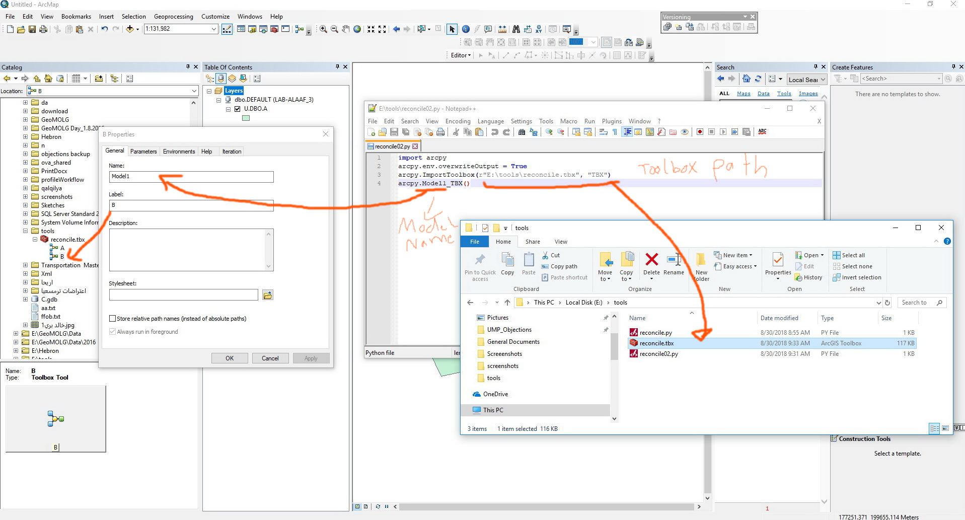

Hi,
FYI, I was able to schedule the python after using the following code as a python instead of exporting the python directly from the model:
import arcpy
arcpy.env.overwriteOutput = True
arcpy.ImportToolbox(r"E:\tools\reconcile.tbx", "TBX")
arcpy.Model1_TBX()
