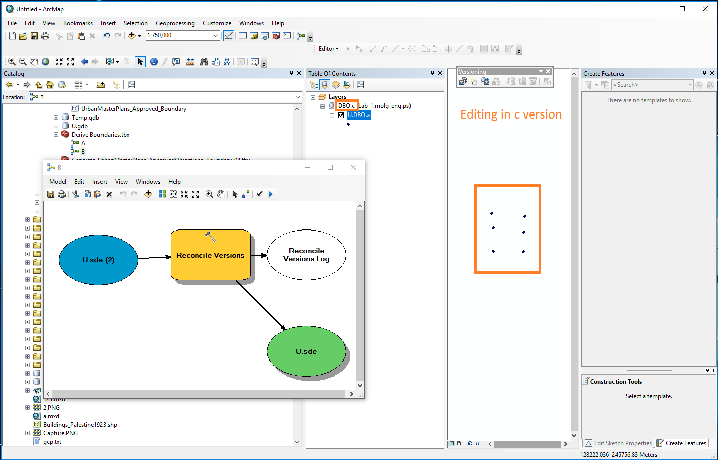

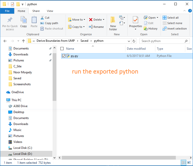

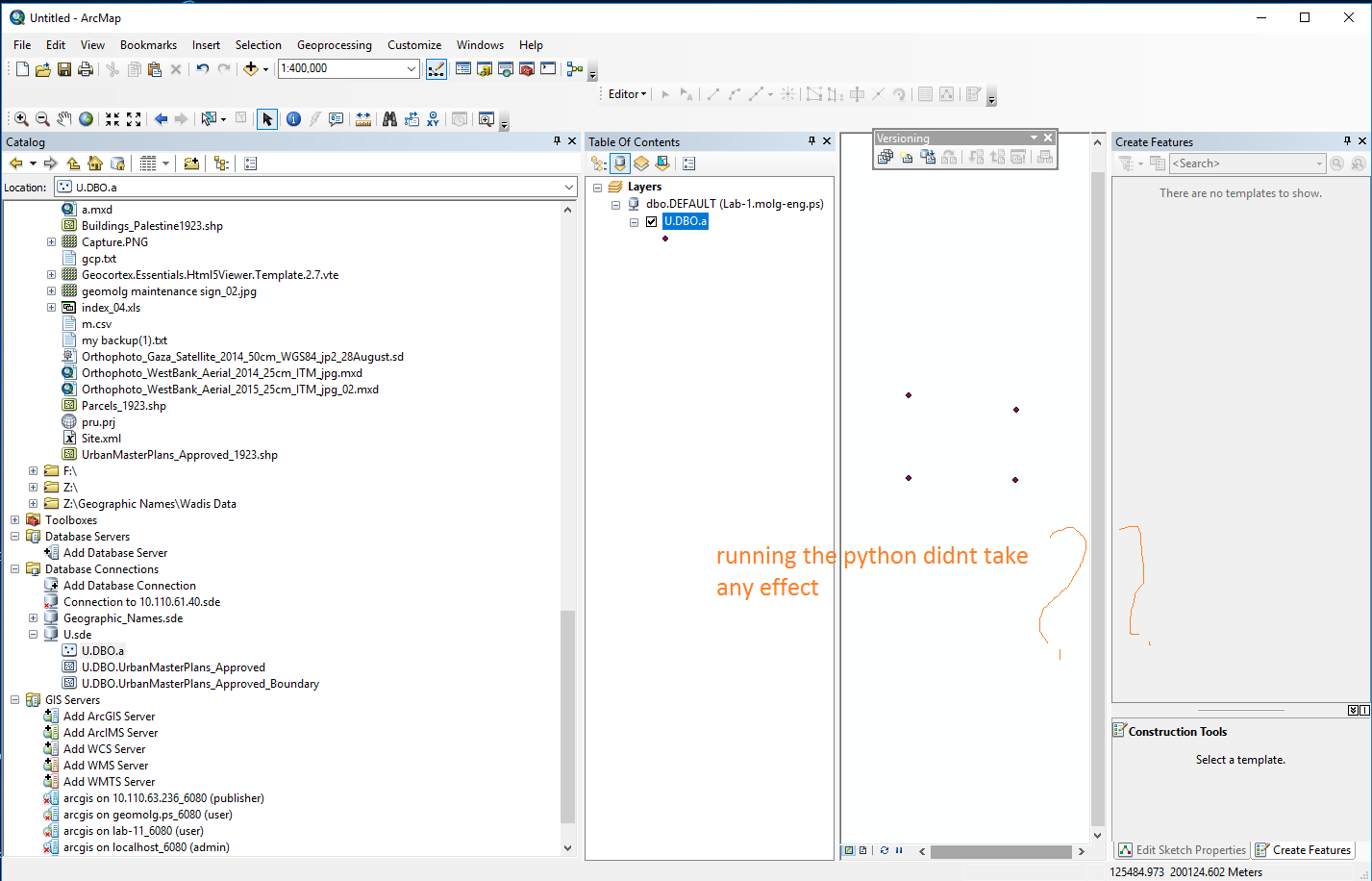

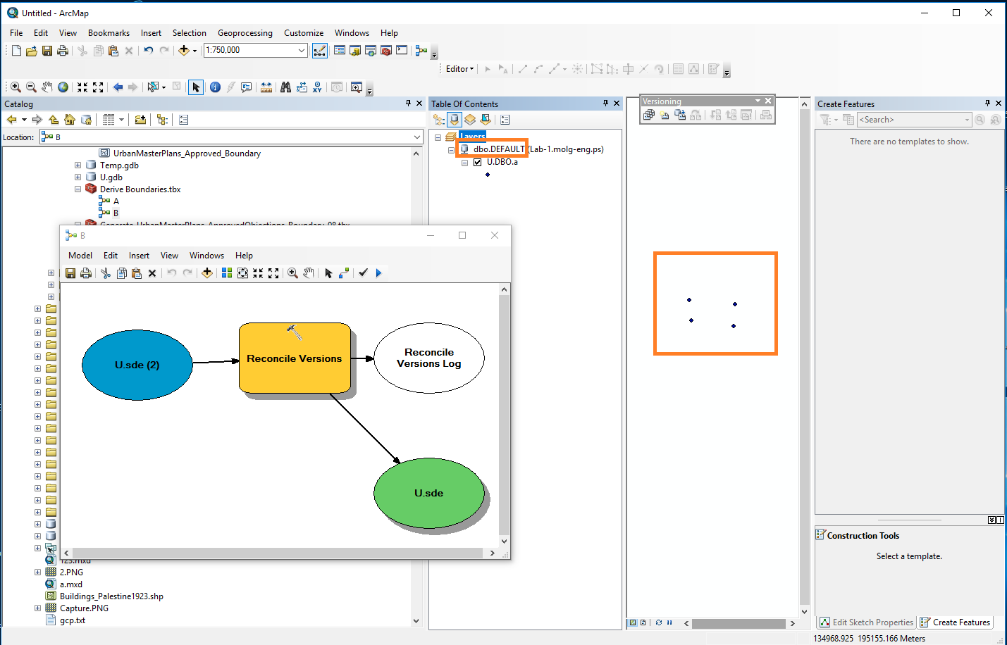

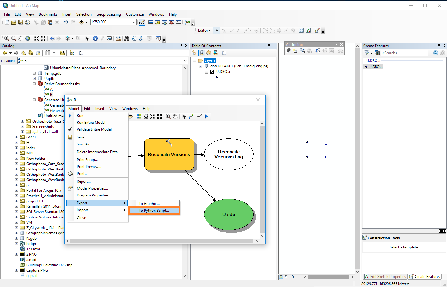

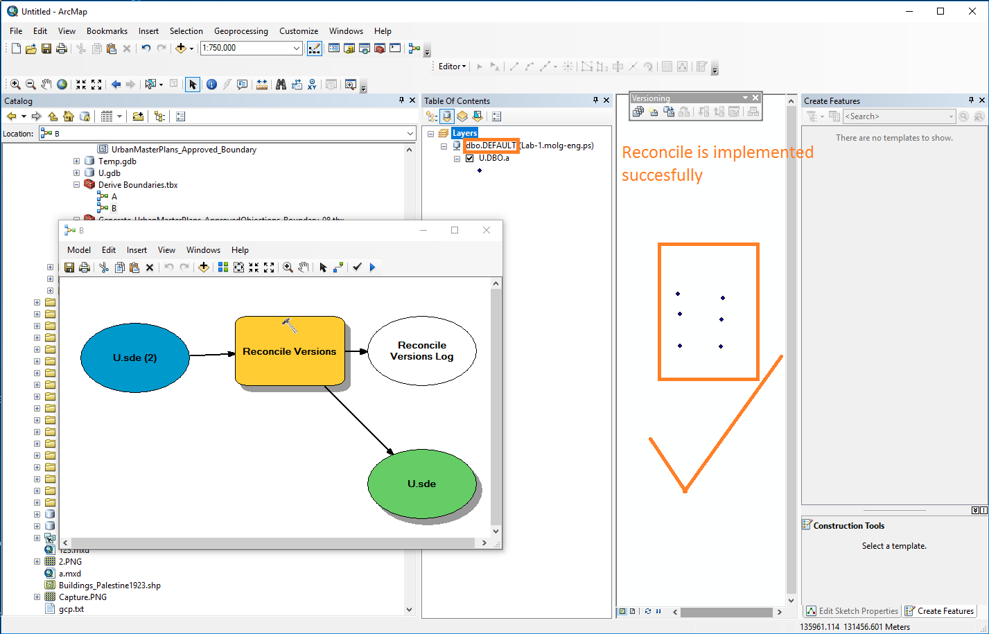

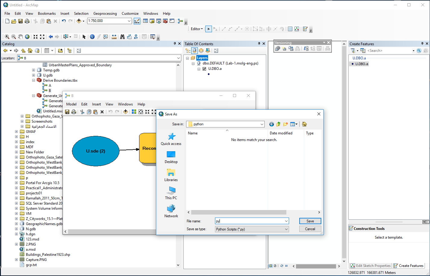

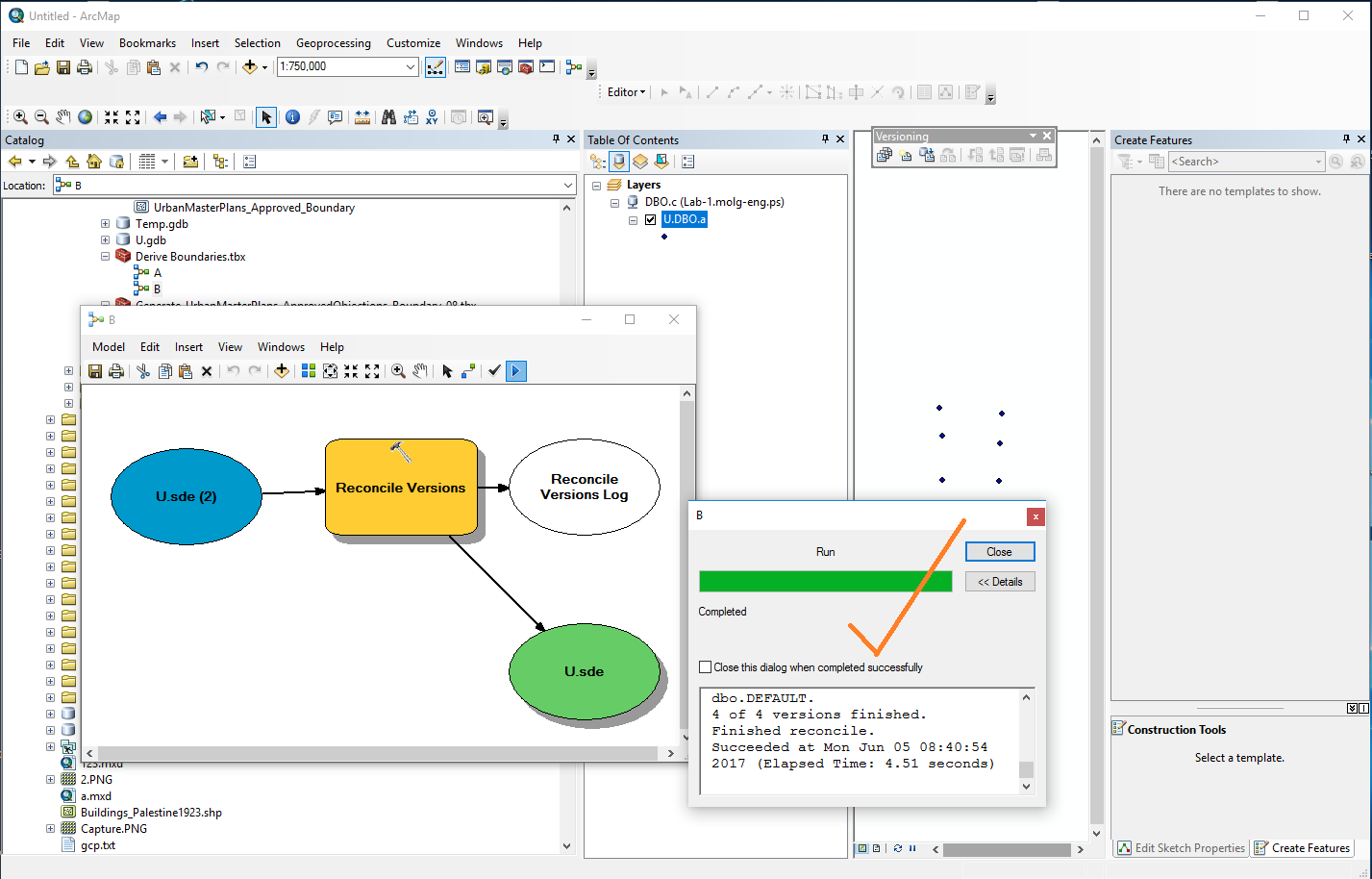

Despite the fact that the model is running successfully in Arcmap 10.5, the exported python is not running as expected.
What might be the issue here.
Please check the screenshots below for more clarification.
Thanks!
Alaa

You might like to compare the script with the code sample in Reconcile Versions.
Also verify why OUT_LOG parameter is not active in the model.

There is really no guarantee exporting to python will work, as the python environment is often different from what you have in an interactive ArcMap session. I think for this reason, Esri (unfortunately IMHO) disabled the export to Python functionality in Pro. I think this is too bad, because this is a great path to get started programming using Python and arcpy.
If you populate the output log file parameter this may give you a clue. Another way to get some feed back (error messages) is to open a command window and run the python script like this:

Hi Alla,
I see that you have draged  "U.sde" form "Database Connections" category  then doped it in your model, is that right?
If you did this The model will work fine but when you export it as a script and run it form windows it will not work.
the solution will be by saving your SDE connection to a local folder and drag  it to your model then export as python.

Hi Alla,
What is the error message that you got?
I see that you didn't define a value for the  location of the Log file variable  (Reconcile_Versions_Log_2 = """)
it should be something like
Reconcile_Versions_Log_2_ ="D:/Db/myLog.txt"

AlaaFlaifel
Hi all,
I was able to run the python by using the following code instead of exported the model directly to python
import arcpy
arcpy.env.overwriteOutput = True
arcpy.ImportToolbox(r"E:\tools\reconcile.tbx", "TBX")
arcpy.Model1_TBX()
Thanks,
