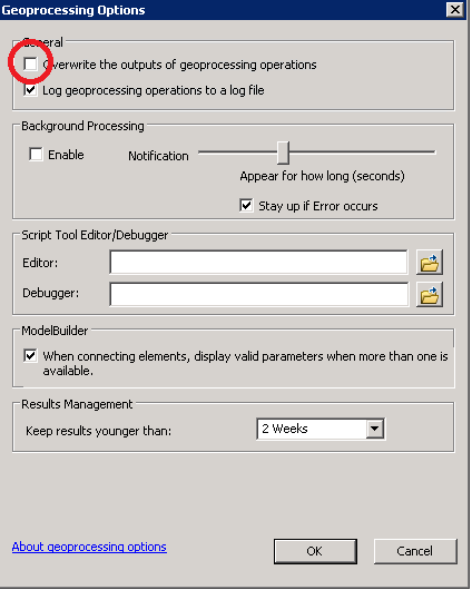

Enable the 'Overwrite the outputs of geoprocessing operations" option on Geoprocessing Options and then try.

Thanks but I have that option checked already. No luck
