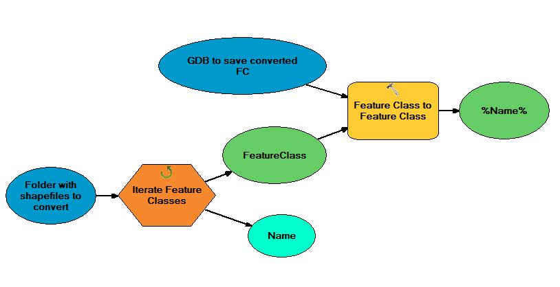

I would use Feaure Class to Feature Class tool and iterators to convert all the shapefiles.
LizaGrits
Deactivated User
Like this:
DanielErklauer
Deactivated User
that's what I have...my folder GIS setting the env is recursive because the shapefiles are in directories withinExport Graphic.jpg the folder GIS.  When I run the model the second time it takes aproximatly1 second

I get the warning error 000258 name already used when I attempt to run the model again to check that it works
LizaGrits
Deactivated User
What tool are you using? Is it just warning or the model doesn't run after this error? Do you want to show your model here?
