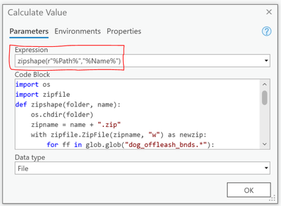

zipshape(r"E:\mypath","open")

The modelbuilder wrapper I set up asks for a path and a shapefile root name. I will update the function doc to make that clear. For example, your call above assumes you have a shapefile E:\mypath\open.shp

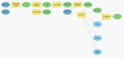

I would think you would want to rename the shapefile and then zip it. If this isn’t in a loop you would use parse path on your shapefile to get the folder and shapefile name to pass to this function.
