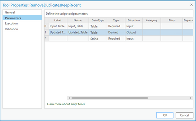

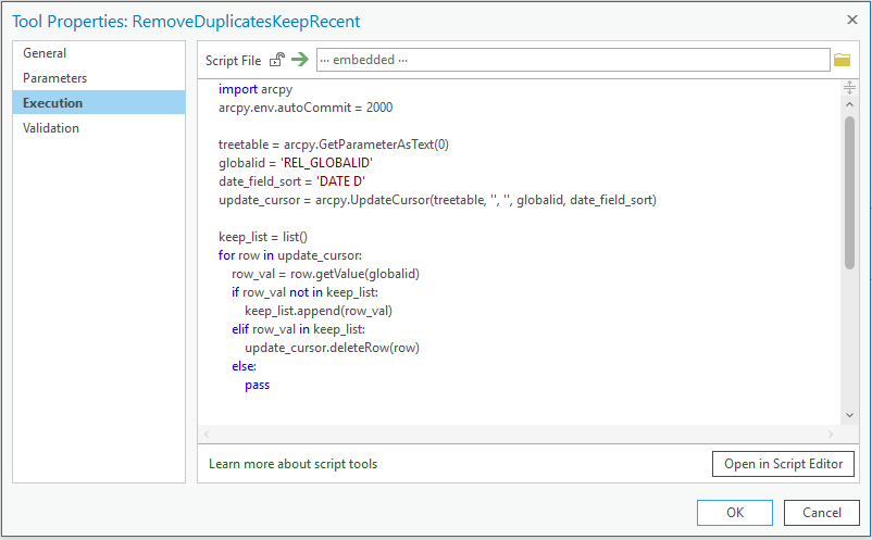

For step three, I created a script tool, which I added into the model. Everything runs fine up until the point where I try to set up the table join. The issue is that it wont let me add the output from the script tool as the join table. It just doesn't recognize it at all. For reference, below are screenshots of the script tool code and parameters:
Can anyone point out what I am doing wrong in this scenario, and how to allow for the output of the script tool can be implemented into the table join step of the model?

I could read the screen shot, but it looked like there was more code below the screen shot under the scrollbar. Looks like the answer to my question was no. To return derived parameters, you must populate the value with arcpy.SetParameterAsText(). Hope this example helps:
import arcpy
arcpy.env.autoCommit = 2000
treetable = arcpy.GetParameterAsText(0)
globalid = 'REL_GLOBALID'
date_field_sort = 'DATE D'
update_cursor = arcpy.UpdateCursor(treetable, '', '', globalid, date_field_sort)
keep_list = list()
for row in update_cursor:
    row_val = row.getValue(globalid)
    if row_val not in keep_list:
        keep_list.append(row_val)
    elif row_val in keep_list:
        update_cursor.deleteRow(row)
    else:
        pass
arcpy.SetParameterAsText(1, treetable)

Here is the code I used. Sorry, didn't realize that the pictures were so low resolution!
import arcpy
keep_list = list()
else:
pass
import arcpy
keep_list = list()
    else:
        pass

Thanks so much for the tips! The arcpy.SetParameterAsText() function achieved exactly what I had hoped for! That was really the only think I was missing, as it turns out.
