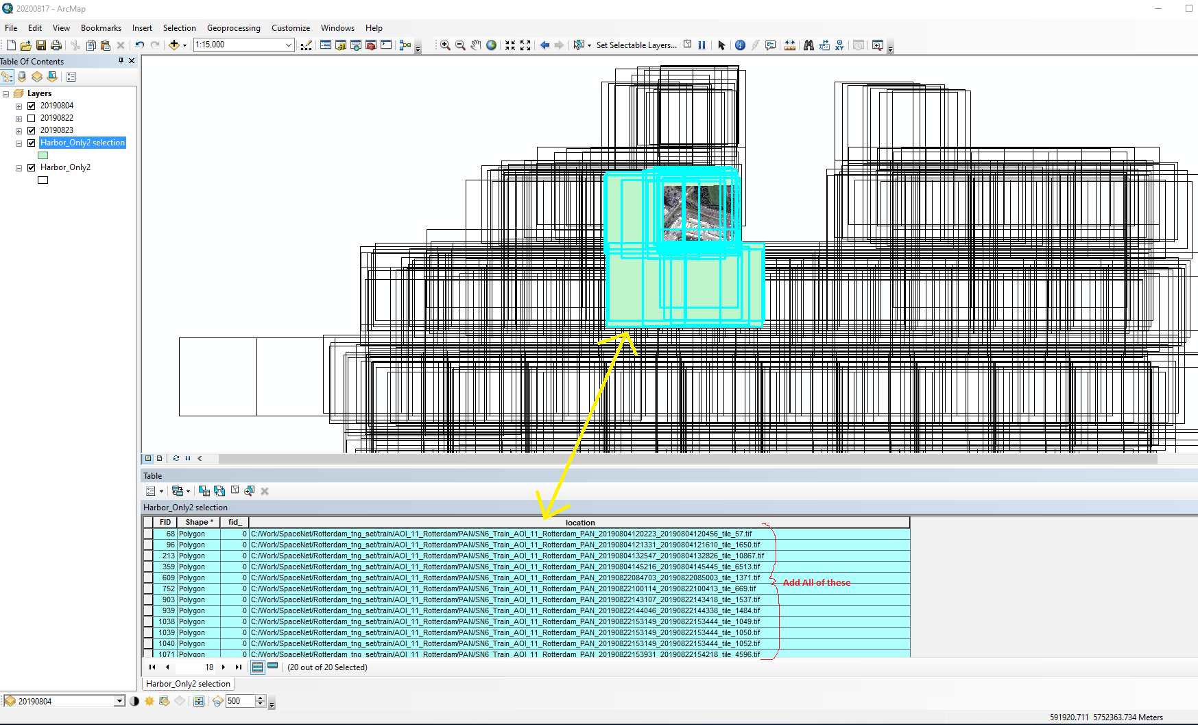

Looking for a way to add several (or a few) tiff file who's full path is listed in a shapefile's attribute table to the data view.
I have a shapefile denoting the coverage of 100's of individual tiffs that I would like to open in the data view after selecting a few based on their location.
The full path to the individual tiff is listed in the attribute table under a field titled "location" in the table. I would like to select a few of the listed tiffs and load them without selecting each one from the normal "Add Data" method.
Basically, have a button that would allow me to add all the selected individual polys associated raster's from the tables listed path.
