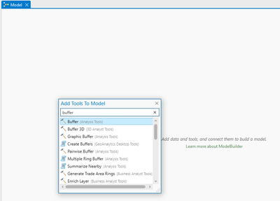

Is there a reason you're going to Command Search rather than just typing on the model canvas? i.e. if looking for 'buffer' to add to your model, just type on the canvas:
Saves mouse travel up to Command Search. That said, if there is a reason that you're still using Command Search, let us know so we can understand what the direct method is lacking.
Thanks!

@KoryKramer  just habit. I didn't know about that click & type shortcut, thanks!

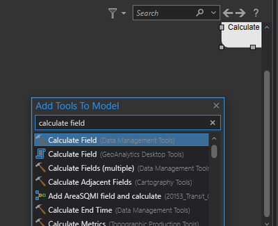

So is that easier than going to Command Search? i.e. now that you know how to directly add a tool from the canvas, do you feel this is a valid idea to keep open?
wayfaringrob
I find it easy enough to add from the canvas, yes. It would be better if that box went away after adding a tool, though, especially since 1) no extra keys/clicks are required to start searching again, and 2) the 'stale' search remains in the box, meaning that you'd have to backspace all that to start a new search anyway. So, I'm not exactly sure what purpose it serves by staying, but it does react to esc which is helpful.
