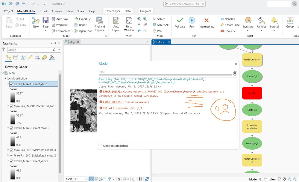

The issue persists to exist in 3.0.2
Is there any other tool that’s equivalent to “select” but to respect the environment settings?
JamalNUMAN
The issue persists to exist even in the Pro 3.1.5

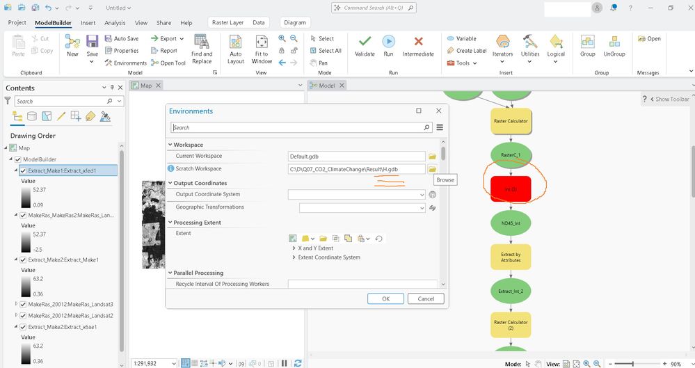

The model builder tool does not respect the “scratch workspace” set in the environment
JamalNUMAN
The issue persists to exist even in Pro 3.4.2
Even using the “validate” tool fails to bring the model tools to the new “scratch workspace”
JamalNUMAN
Here, the “integer” tool fails to respect the “scratch workspace” set in the environment.
Is this by design?
JamalNUMAN
This is not enhanced even in 3.7.0
