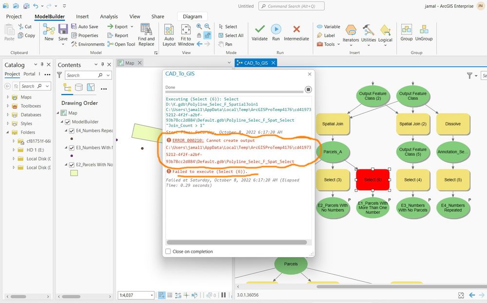

It would be great if the Pro ensures that all tools performed in model builder respect the “scratch workspace environment”.
This issue is also discussed here:
ArcGIS Pro 2.8.4: A model builder tool fails to respect the scratch workspace environment and ends u...

Hi @JamalNUMAN the question you cited refers to https://pro.arcgis.com/en/pro-app/latest/tool-reference/analysis/select.htm The Select (analysis) tool isn't a specific ModelBuilder tool. As was stated on that other thread, not all tools respect all environments. In this case, it sounds like you need the Select tool to honor the Scratch Workspace environment. I wonder if making this idea specific to that would make it more actionable...
In the meantime, have you tried using the memory workspace if you don't need to persist it? "Data written into memory is temporary and is deleted when the application is closed, so it is an ideal location to write intermediate data created in a ModelBuilder model or Python script."

The issue persists to exist in 3.0.2
Is there any other tool that’s equivalent to “select” but to respect the environment settings?

The issue persists to exist even in the Pro 3.1.5
The model builder tool does not respect the “scratch workspace” set in the environment

The issue persists to exist even in Pro 3.4.2
Even using the “validate” tool fails to bring the model tools to the new “scratch workspace”
