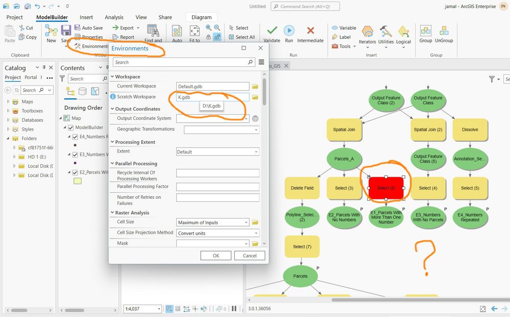

The model builder tool does not respect the “scratch workspace” set in the environment
The issue persists to exist even in Pro 3.4.2
Even using the “validate” tool fails to bring the model tools to the new “scratch workspace”
Here, the “integer” tool fails to respect the “scratch workspace” set in the environment.
Is this by design?
