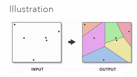

Check if Creating Thiessen Polygons fulfills your requirement.

Okay let me try that. Thank you.
