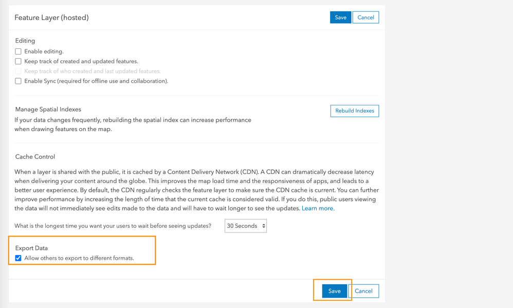

Begin by reviewing the item Settings and updating as needed. Click on the ‘Settings’ tab.
As appropriate, mark the item as ‘Authoritative’ and check the box to enable delete protection. Check the ‘Export Data’ box to allow others to export different formats. This will enable downloads for your open data. Click ‘Save’ then return to the Item ‘Overview’ tab to return to the Item details page.

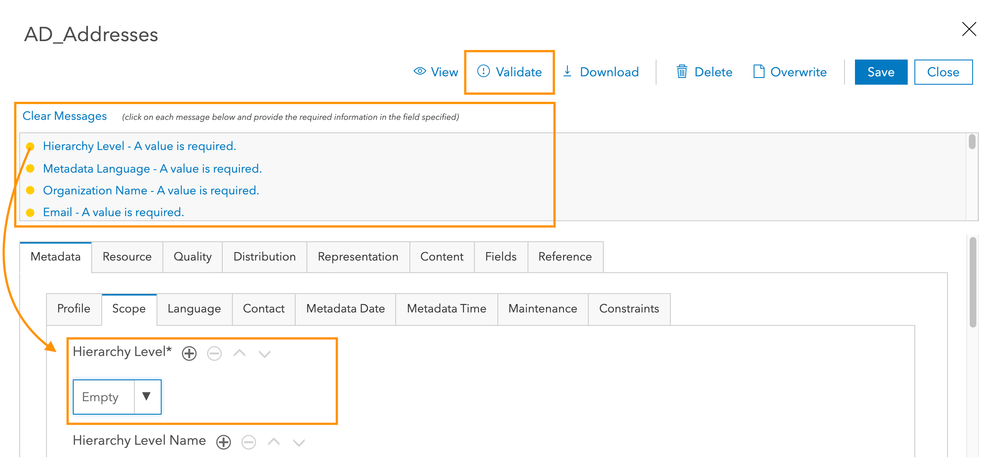

Click 'Validate' to reveal the INSPIRE required elements dialog.
Clicking the metadata editor 'Validate' runs a check to see what required elements have not yet been completed. A click-through dialog is presented for the missing required values, denoted with a yellow circle. Use this dialog to guide you through the creation of your INSPIRE metadata. Depending on if you have some metadata already completed, the metadata elements required to be completed may differ slightly from what is shown below.
Create Metadata
To start, click ‘Hierarchy Level - A value is required.’ Your cursor moves automatically to the element in the metadata editor, in this case, ‘Hierarchy Level’ with a dropdown menu.
Continue clicking through each Validate message and provide the required information in the field specified. The following provides detailed guidance for completing each metadata element to create valid INSPIRE Metadata:

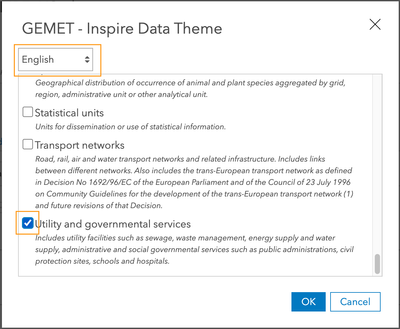

  • Keywords - the primary INSPIRE theme keyword of the dataset; click “Lookup” to open the GEMET Keyword Lookup Browser. After a moment, the ‘GEMET INSPIRE Data Theme’ popup will open
      • Choose a language as appropriate in the language dropdown.
      • Check a box to select exactly one GEMET Keyword matching the INSPIRE Theme of the layer (note, choosing more than one theme keyword will produce “Fail” results in the external INSPIRE Validator). Click ‘OK’

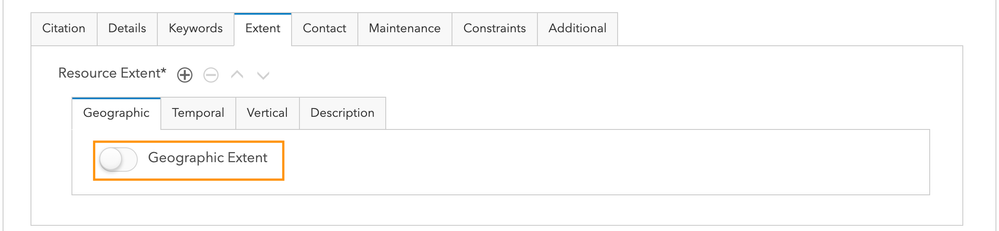

  • At least one Geographic Bounding Box is required - toggle the control to turn on Geographic Extent
Use the popup map to interactively draw a bounding box around the extent of your data; Click ‘OK’

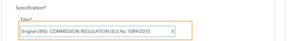

  • Title - the title of the specification used for the above conformance result. Choose the language of the INSPIRE specification title from the dropdown list to add the full title in the specified language to the Metadata record
  • Publication Date - enter “2010-12-08” (enter exactly as written, without quotes)

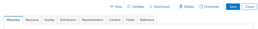

Click 'Save' then view your metadata
Click ‘Save’ to save the metadata. Click ‘View’ then the ‘Save and View’ button to view the metadata in a separate tab.

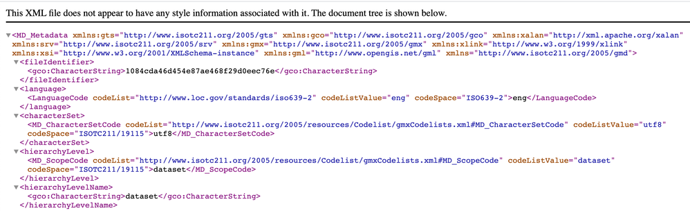

Important: The metadata are presented in human-friendly HTML. However, the external INSPIRE Reference Validator requires XML encoded metadata. To view as XML, find and delete “&output=html” from the URL string (hit ‘Enter’ on your keyboard to refresh the page with the edited URL).
Copy the URL of the XML metadata from your browser menu bar. Alternatively, use your browser ‘File > Save As’ menu to save the XML file to use with the INSPIRE Reference Validator.

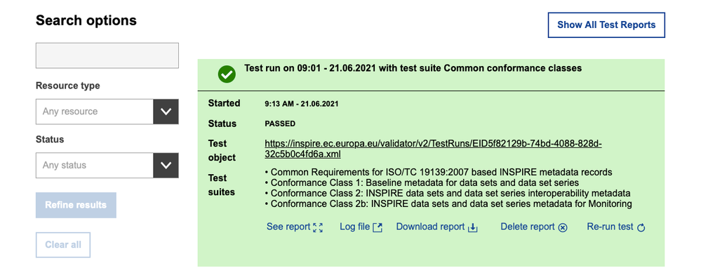

Check your Metadata using the INSPIRE Reference Validator
In a web browser, open the official INSPIRE Reference Validator and click ’Test your data, services, or metadata’ to start a test.
The validator is already configured to test your metadata using the Technical Guidelines version 2.0 for data sets and data set series metadata. Verify your answer to the antispam question.
Add your metadata to be tested
Follow instructions to provide your metadata to test and click ’Start test’.
Check the Status of your report
The validator runs its tests and generates a report. View the results to see your metadata "Passed" inspection. If you left fields blank or incorrectly filled in metadata elements when creating your metadata, it may fail some tests. Click the “See report” link to expand sections and view detailed results. Then, return to the ArcGIS Metadata Editor and update your metadata, as needed.
