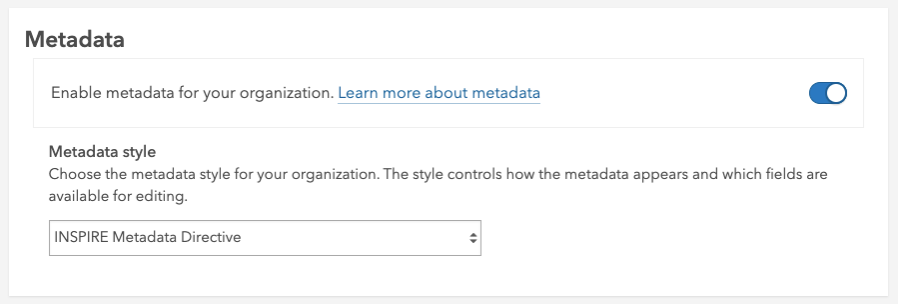

Administrators configure the metadata style in the organization settings.Administrators configure the metadata style in the organization settings.
  • Verify that you are signed in, have privileges to create content, and that your organization has enabled metadata.

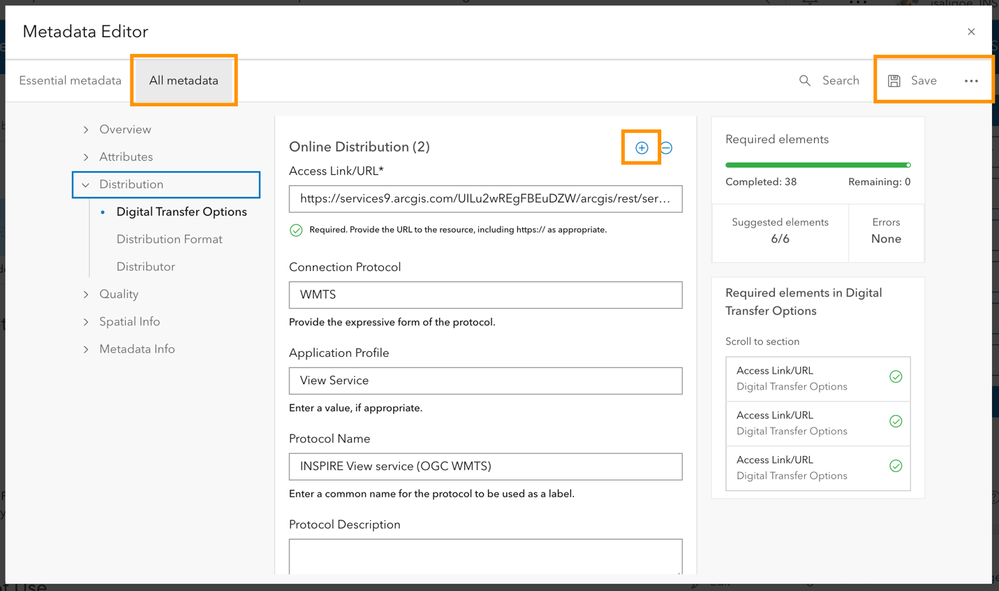

  3. Update the Dataset Metadata – Return to the parent layer and open the metadata editor. Click the ‘All metadata’ tab and choose ‘Distribution’ from the left sidebar. Complete the following information:
    1. The first ‘Online Distribution’ > ‘Access Link/URL’ automatically provides the GeoServices REST URL.
    2. Click the ‘+’ next to the ‘Online Distribution’ heading to add another distribution.

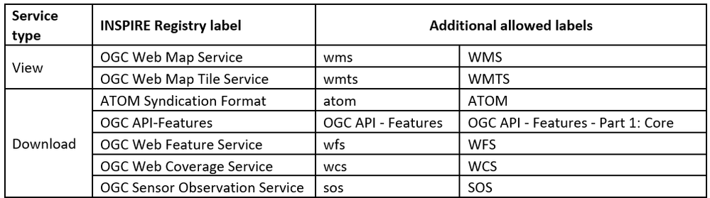

      1. Access Link/URL – paste the URL of the WMTS from the Tile Layer from the previous step.
      2. Connection Protocol [5] – enter the label “OGC Web Map Tile Service” exactly as written, without quotes.
      3. Application Profile – enter “View Service” exactly as written, without quotes.
      4. Protocol Name – enter “INSPIRE View service (WMTS)”
      5. Distribution Function – choose “Information” from the drop-down list.
    3. Click the ‘+’ next to the ‘Online Distribution’ heading to add another distribution.
      1. Access Link/URL – paste the URL of the OGC Feature Layer from the previous step.
      2. Connection Protocol – enter the label “OGC API-Features” exactly as written, without quotes.
      3. Application Profile – enter “Download Service” exactly as written, without quotes.
      4. Protocol Name – enter “INSPIRE Download service (OAPIF)”
      5. Distribution Function – choose “Download” from the drop-down list.

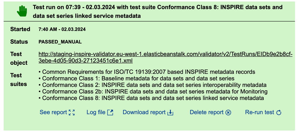

Check Your Metadata Using the INSPIRE Reference Validator
IMPORTANT UPDATE: As of 1 April 2026, the European Commission has stopped maintenance of the INSPIRE Validator. This section is retained for historical purposes.
You will use either the metadata URL or download the metadata XML file for testing.
For publicly shared items, copy the URL from your browser menu bar up to ?format=default (do not include the &token= ).
Alternatively, use your browser’s ‘File > Save As’ menu to save the XML file for use with the INSPIRE Reference Validator.

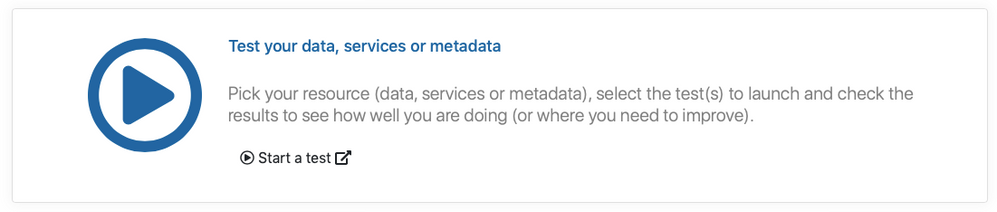

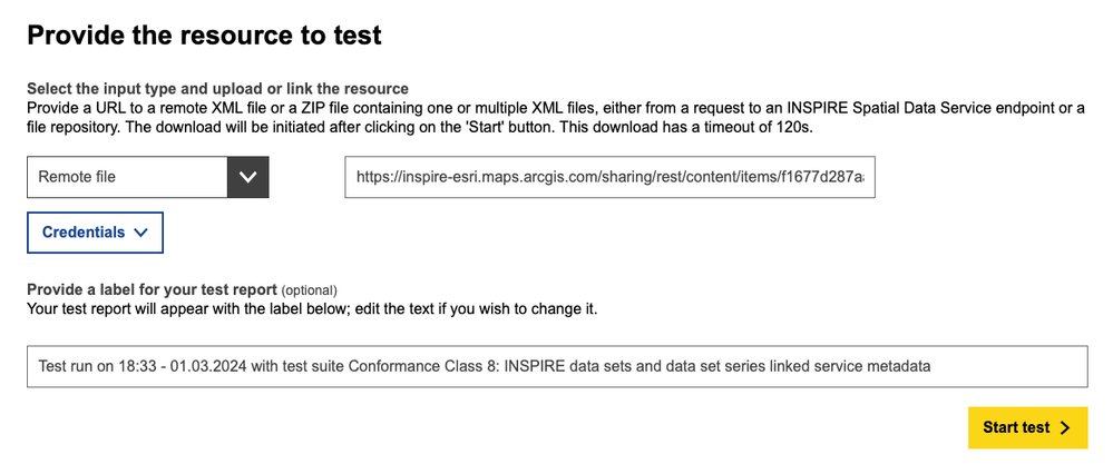

Open the official INSPIRE Reference Validator in a web browser and click ’Test your data, services, or metadata’ to start a test. Advanced options include Conformance Class 8: INSPIRE data sets and data set series linked service metadata (for additional distributions described above).
Add Your Metadata To Test
Choose ‘Remote file’ or ‘File upload’ then follow instructions to provide your metadata to test and click ’Start test’.
Check the Status of Your Report
The validator runs its tests and generates a report. View the results to see your metadata "Passed" inspection. It may fail some tests if you left metadata elements blank or incorrectly filled in elements when creating your metadata. Click the “See report” link to expand sections and view detailed results. Then, return to the ArcGIS metadata editor and update your metadata as needed.
