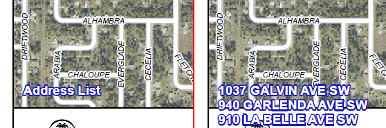

I'm trying to position a text element in the bottom-left corner of my map, but having a problem that seems similar to these.
     Print Service not honoring Anchor Points​​
     Data Driven Page Name Location Issues
     Dynamic Text in Data Driven Pages won't stay put
Specifically, I want to replace the text using ArcPy; however, despite that I made sure the text element is anchored at the bottom-left, when I change the contents, it behaves as if the anchor is in the top-left, and text sprawls off the bottom of the page:
Is this expected behavior?  What am I missing? Do text elements simply not respect (at least the vertical aspect of) the anchor point; does it anchor only the first line; does the anchor not update when text is changed?
I can probably position it myself in the script, but I'd like to know if there's a better way.

BrandonNelson1
Yes, it's regular/point text; I had forgotten about the vertical alignment setting, thanks. (Arc seems to have quite a few "well-hidden" features....)  After setting that, I can change the text manually in ArcMap and it aligns correctly, but unfortunately it still comes out wrong when changed in ArcPy.

BrandonNelson1
In fact I was looking into #2 when I got your response, and that did it.  I save the element position, change the text, then restore the original position:
AddrList = arcpy.mapping.ListLayoutElements(Document, "TEXT_ELEMENT", "AddrList")[0]
position = AddrList.elementPositionX, AddrList.elementPositionY
AddrList.text = "New\ntext\nwith\nmultiple\nlines"
AddrList.elementPositionX, AddrList.elementPositionY = position
I also tried #1 out of curiosity (it didn't pan out :/).
